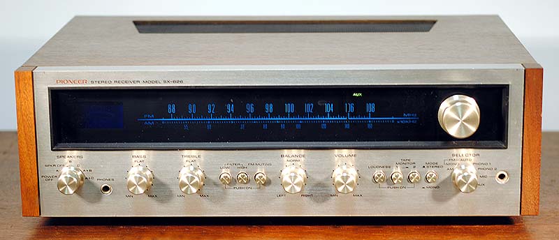

    Long story short, I have a vintage stereo system I inherited from my mother years ago. I have a mid 70's Pioneer SX series receiver and two massive custom built speakers.
    The receiver stopped producing audio. It powers up, but that's it. I left it alone for several years, but I kind of want to get it working again.
    Are there people out there that repair these vintage receivers? I love the way this thing looks when it's on and when the lights are down low or off. With the crazy custom built speakers, it produces excellent sound.
    I actually found a picture of what it looks like.

    I have been wondering about things like this... Is this when people just recap them?

    Have you popped the top to check the fuses? Could be as simple as that.

    Check the fuses...
    Other than that, there's a few places that will repair it, but i would suggest trying to find a place local. It's likely that it blew a couple resistors or the caps have finally leaked enough to bork something else.
    This is the point where you have to decide how much it's worth to you. You won't be walking away less than $100-$150 lighter in the wallet.

    It's a little unusual that it would stop making any sound at all. You might try it one more time, and work every switch and every knob. Sometimes a dirty tape monitor switch will make a load of silence, but that's a really, really easy fix.
    With both channels dead, I'd maybe suspect a dirty speaker relay. Does it have pre-out/main-in? Sometimes jumpers get pulled and no one notices.
