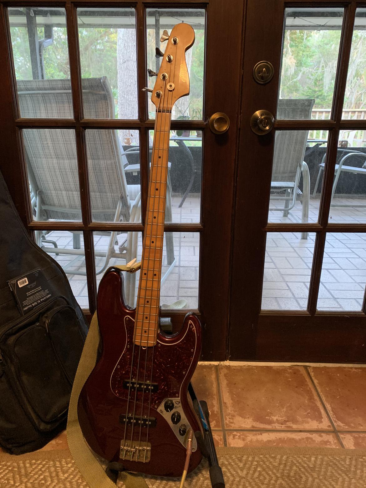

Lately this has been my go-to even though, I admit, I generally prefer my P-basses.
This was hanging in my guitar teacher's classroom one day. What's up with it? I asked.
It's a mishmash of parts and came in as part of a smaller collection. Best we can tell, it's a Fender body, '70s Aims neck (feels more like a P-bass), American Fender electronics, flatwounds and what looks like an old bridge. I traded a pedal and maybe $200 for it. He set it up, and it plays nicely.
More of the story, I guess, is it to become friends with the local shop.

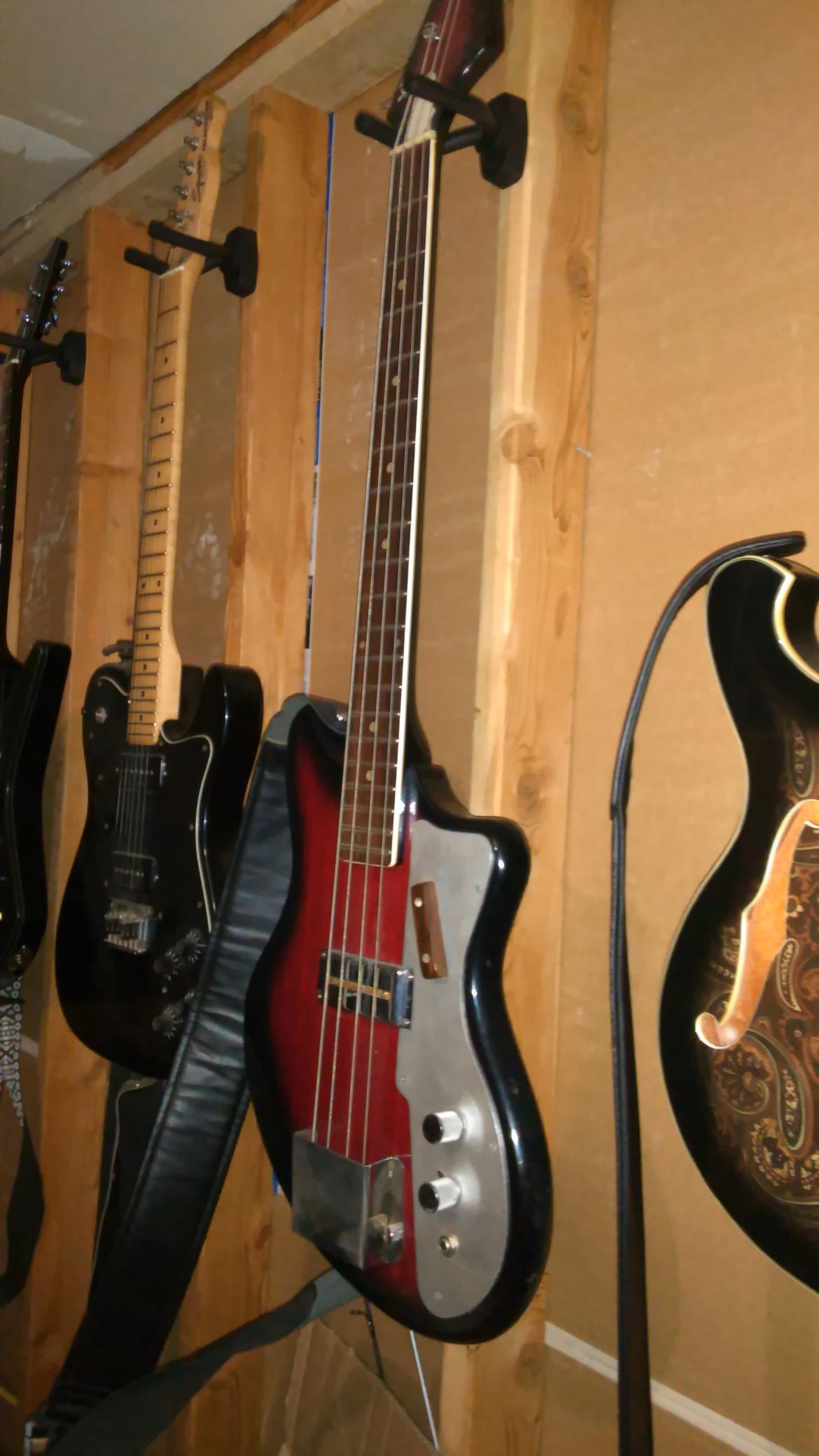

I only really own weird short scale basses, this is the one I play the most. Ginormous neck on it

Dude... I had that same bass! I stupidly traded a sweet minibike I used to have for it. The one I had was beat to hell; the electronics were shot, the bridge was unusable, the tuning machines were loose, and the binding on the neck was falling off. I left it at my favorite music store as a "donation" a few years ago. When it did work, it had a really cool sound; very early Geezer Butler tones came out of it with ease.

That's cool, this one has a very fundamental tone that I love, I could totally see it doing geezer tones too.
That one and I somehow have the same weird bass Kurt Cobain used early in his career. I saw a pic in a museum and had no idea. I just bought it because short scale maple neck jazz basses are pretty rare and it played nice

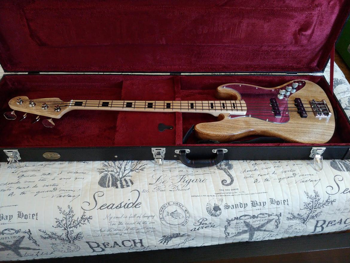

I made this!
It still needs the string retainer installed and a couple holes filled/drilled for the pickguard but I plugged it in and strummed at it yesterday for the first time. It's not adjusted at all yet either but that will come after a few days of tuning and strumming to let it "settle". That may not be necessary, but I'm going to let it settle before playing around with action and intonation and all that jazz (sorry).
It's a Solo kit that I got the analysis paralysis on and upgraded almost everything on while making it.
Biggest lesson? It seems Jazz Bass parts don't fit all Jazz Basses - or any for that matter. They appear to be a real, poorly documented, mish-mash of subtle changes. The only upgraded part that didn't need hacking and slashing and scorched earth was the bridge.

That's BEAUTIFUL!
Depending on the year and where they were made, Jazz Bass stuff can differ slightly. Even the pickguard I put on mine needed a little massaging to fit.

The finish was, as Bob Ross says, "a happy accident". I stained it dark walnut and applied teak oil over that. The oil felt rough after it dried so I sanded it to take the oil off and it knocked the stain off the top of the grain. I was unhappy because the walnut looked pretty. However, after accepting that the rough needed to go, I continued sanding. Happy accident! I liked it better sanded out, so I waxed it and left it. The fun part was trying to duplicate the hap-hazard finish on the headstock (face only). The chrome pickguard is for a Japanese model apparently and I need to fill/drill 3 holes as they're half a hole out. 2 holes matched the kit body's pattern and the balance were far enough out to easily re-drill.
Upgrades from the kit are MUCH nicer tuners, high mass bridge, better pots and tone resistor with a push-pull pot set up for series/parallel wiring and a graphtech nut. The pickups are also an upgrade which involved re-drilling the hole pattern and routing the bridge pickup ear slots a bit larger. It was the new pickups which started most of the upgrades because I had to make them fit. So why not just dive in and try stuff out?
I also drilled the body from the backside and installed 8 M3x0.5mm threaded inserts for the pickup screws. I can micro-adjust the pickups to exactly where I want them to be in relation to the strings and not have to concern myself with stripped screw holes.

Maple necks always look better imo
And usually play better too

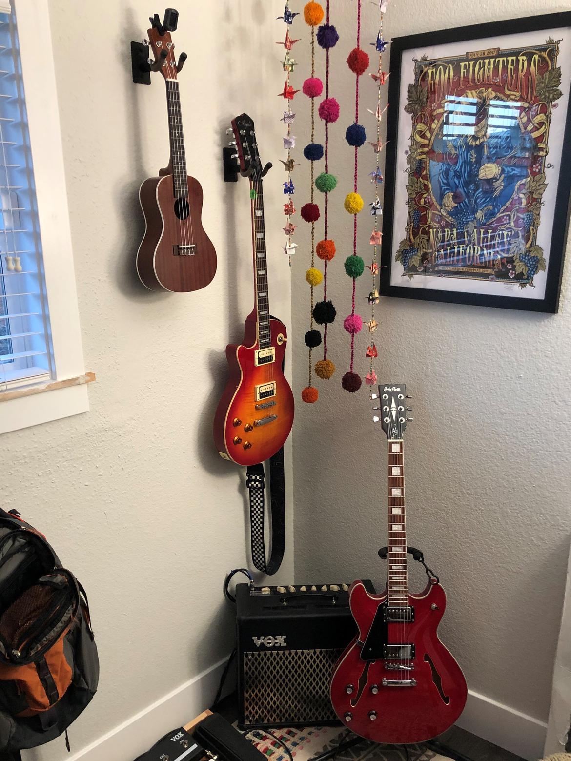

With the current "shelter in place orders" here in CA, I'm trying to make the best of it and work on those things you never make time for.  Spent last night re-stringing, cleaning and polishing the frets, and just giving the two a good detailing.
The Agile I've had for years, and is built like a tank, and with the SD Slash pu's has a great heavy, crunch to it.  The Harley Benton is a relatively new purchase, and so for I'm super impressed w/ it.  Build quality is great, arrived perfectly tuned, fretwork was good.  The fret board was crazy dry, but other than that so big, obvious flaws.  It also has push/pull knobs for splitting the pickups, which I've never played with before, and it's kinda fun to mess around with.
(The Uke is the wife's, and it has been getting some heavy use during the WFH time)
