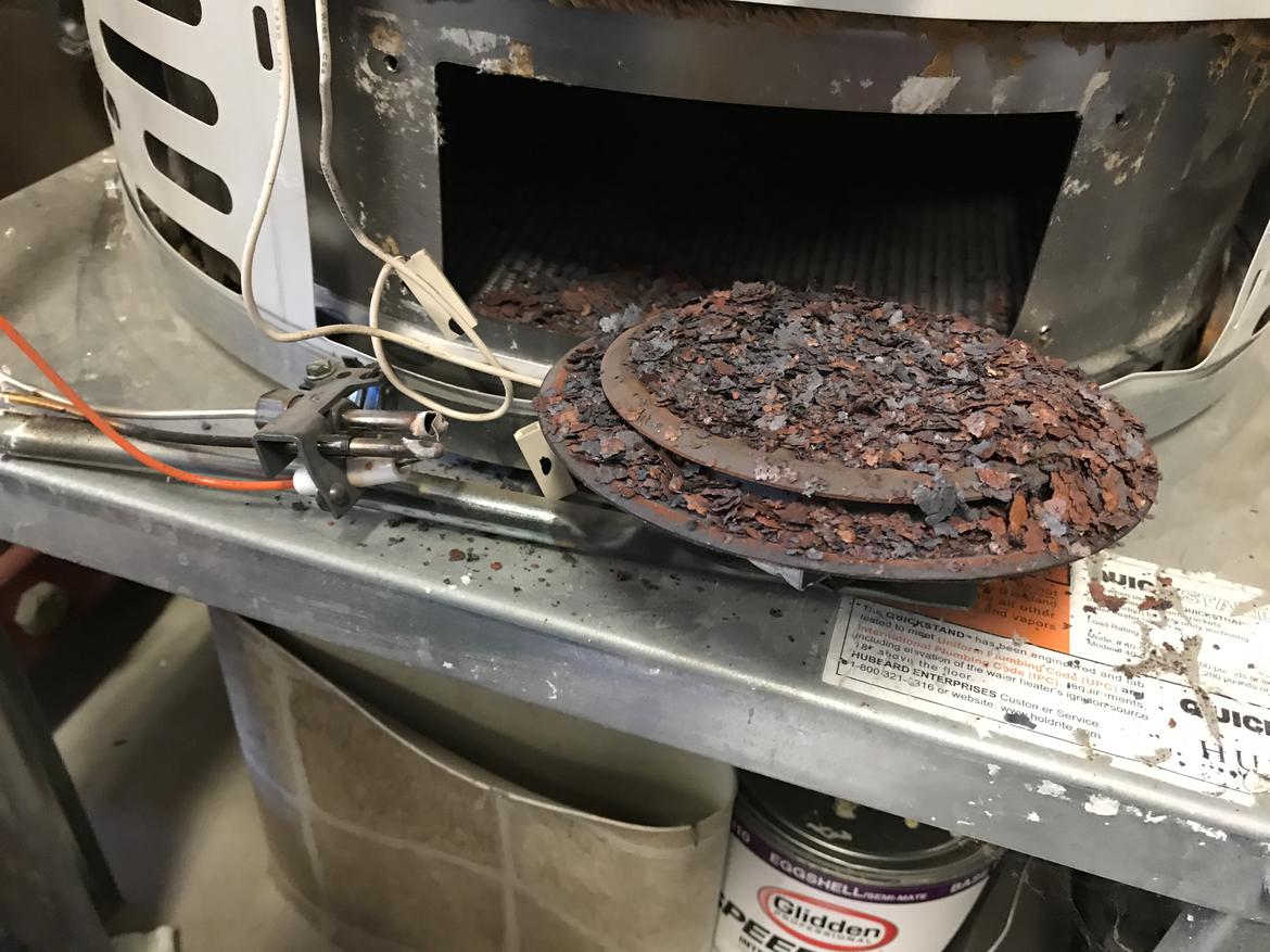

Everyone is feeling better, finally.
and now the water heater is acting up.
The burner and pilot light won't stay lit for very long.
I know its never been serviced, so now I get to learn about natural gas hot water heaters.
Of course the wife is making comments about how "everything is falling apart around here"
Yeah its been there since 2006, I'd say its had a good long run, so lets not go throwing "everything" into the trash, eh?

If it has a pilot light instead of a electronic ignitor, it has a thing called a thermocouple. It sits in the flame of the pilot and creates a signal down a tube that tells the gas valve to keep the pilot lit.
Cheap, pretty generic, available at any hardware store. I keep a spare hanging beside the furnace and water heater.
In reply to Streetwiseguy :

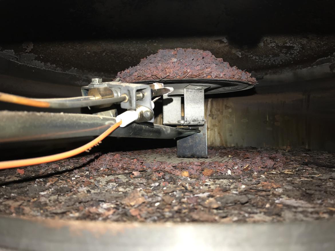

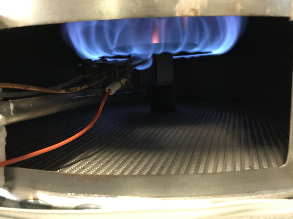

Seems like it just needed to be cleaned up...
After a thorough vacuuming, cleaning the burner and shining up the thermocouple it works again.
I need to look at the parts diagram to figure out what rusted out, but at least its working again.
wow.. that rust is a bit scary looking. I would be considering a new hot water heater soon
In reply to mad_machine :
yeah, I believe it’s the baffle that runs up the middle.
