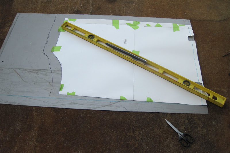

    Mocking up the door skin in poster board

    I spent most of the day doing non-car stuff, but took the time to transfer my paper pattern to the sheet metal
    so I could cut it and hold it up to the door frame
    Note the extra material I left all around so that the sheet metal can be bent over the tube and riveted on the inside surface of the door frame where it is less visible.
