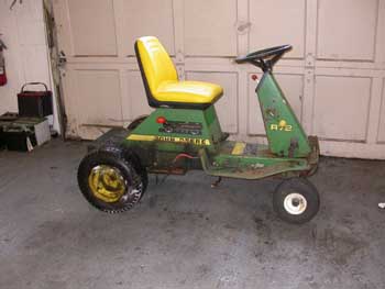

    To follow-up on David's posts, here's what we did with a rear engine John Deere:
    We used the junk frame, steering, brakes and wheel/tires from the rider and added a horizontal shaft 3HP Briggs with a centrifugal clutch. The only thing we bought new was the clutch ($30)
    --Carl

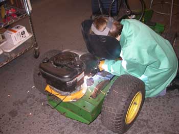

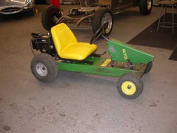

  • Carl Heideman
    Oct. 26, 2009 6:45 p.m. Carl Heideman
    The one above was actually the 2nd one we built. We put the smaller motor and the centrifugal clutch on it because it was for my 7 year old and we didn't want it to go very fast or accellerate very fast. Before we built that one, we built one for my now-13 year old--he was 11 at the time. It looks similar, but has a vertical shaft 6 HP Briggs (which revs to 5200 RPM without the governer and hasn't thrown a rod in 2 years--tick tick tick). It also has a Peerless 5 speed transmission that is in just about every rear engine lawnmower made (and many walk behind snowblowers for that matter). It uses a foot clutch and a belt drive to the trans. We've got it geared to go up to about 30MPH in 5th gear, but I don't let my son get it up that fast yet (and I want to stay married).
    I don't have a photo of the finished kart handy, but it looks a lot like the simpler version. Here are some construction photos.
    --Carl
