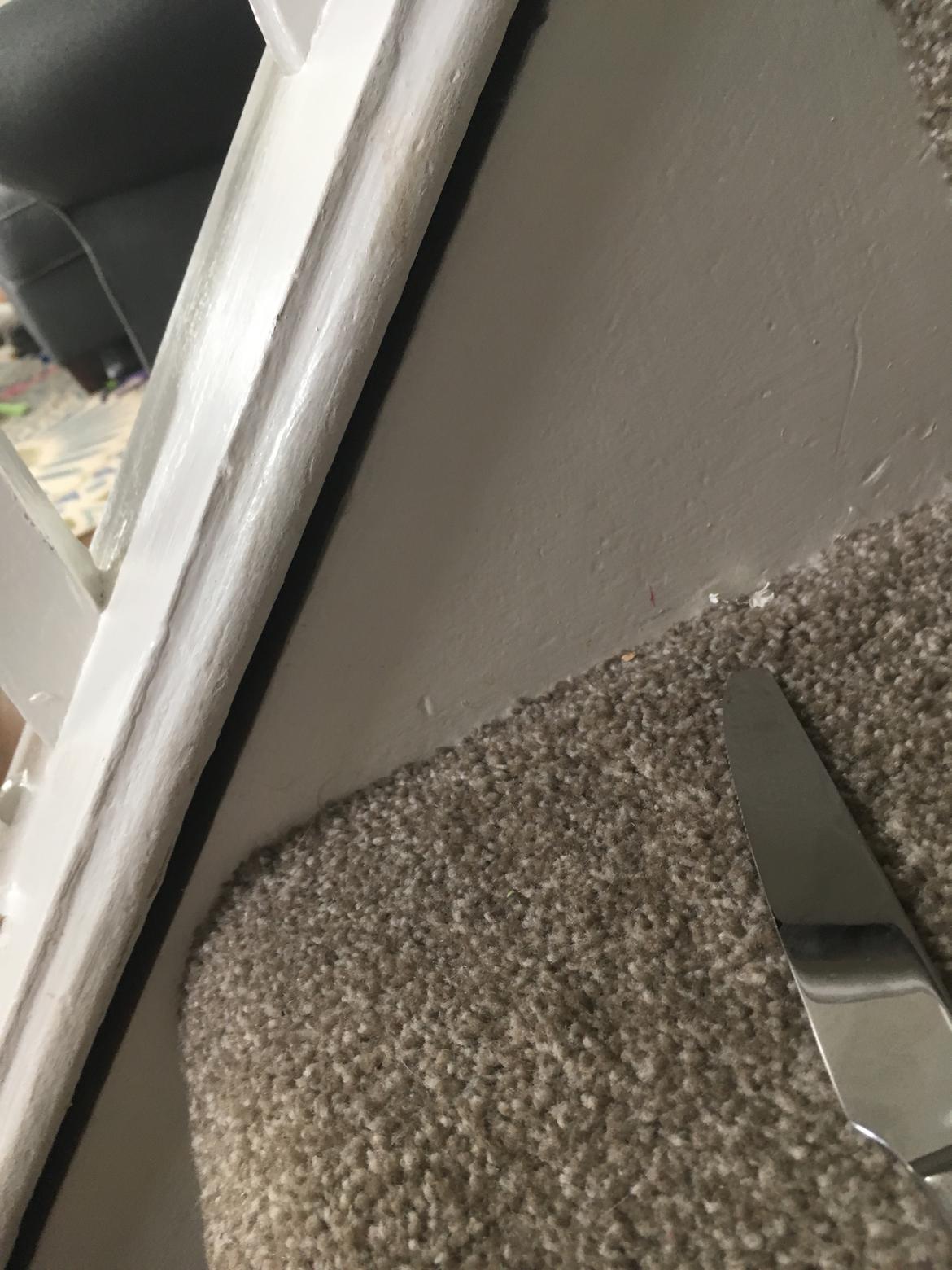

My stair banister has come loose thanks to a compression type baby gate that pushes on the banister.

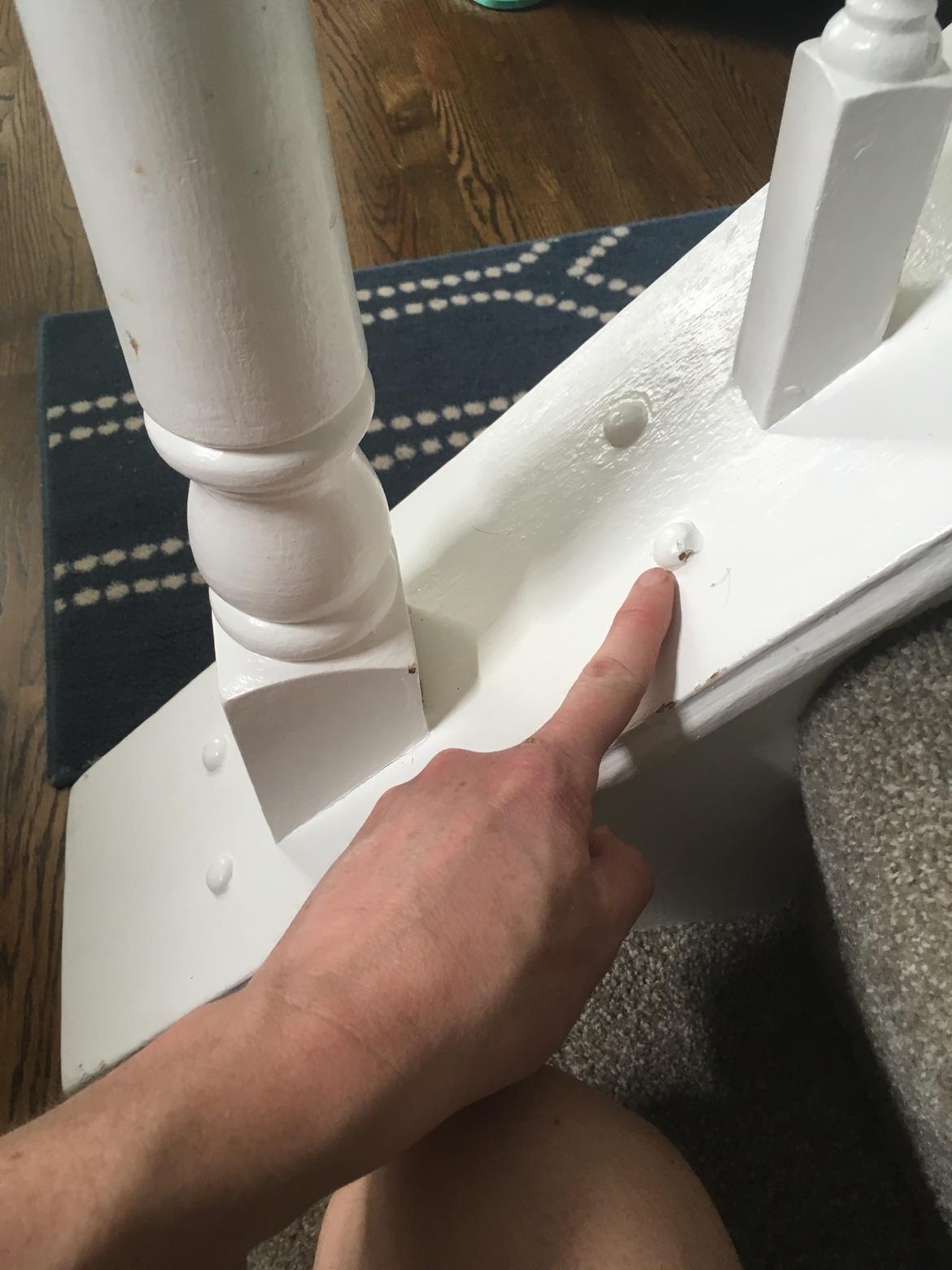

You can see how far it has separated from the cap (pic 2). My question is how do I fix this? And do these cap/rivet things have screws or nails underneath? This is an older Ryan home from 1969.
I'd be tempted to fill it up with wood glue, and then maybe some screws at an angle up from the side (that way the screw head is less visible).
If that didn't work I'd slam some screws down from the top and then fill/paint if I really cared about looks. Good news is the white paint will make whatever you do much easier to hide than a stained finish.

I think I’m gonna counter sink some screws down from the top. Seems like the only choice right now.

Maybe pop the plugs off the existing screws, use an impact driver to pull them out, put some toothpicks in the holes, and drive them back in?
There are screws under those plugs. Plugs may be glued, in which case wood glue is stronger than wood and may break things. I would get some flush plugs, make the correct size holes for the plugs and add new screws, then sand/fill the plugs and repaint.

Long lag bolts, go big or go home.
