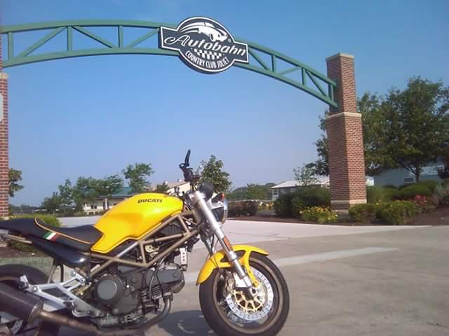

pres589
pres589 PowerDork
5/5/18 9:09 p.m.
Cooter, that bike looks fantastic. So what is it exactly? I don't speak Duc very well so I don't know what a 944 conversation is. What did the frame leave the factory as?
markwemple
markwemple UberDork
5/5/18 9:15 p.m.
It's a 2000 900 monster. The 944 kit is a 944cc kit. The Duc ST2 is a water cooled engine but the pistons and cylinders can work in an air cooled 2v with the coolant passages closed and the oil passages opened up.
