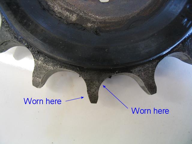

    Started getting a noise in my drivetrain as well as some slight jerking...
    Looking at these pics, do I have a bad chain or bad alignment? there's a section the doesn't seat on to the sprockets right

    Looks like you're due for a new chain and sprocket.

    Agree with Woody. Given how worn that sprocket appears to be, I don't think there is a chain or alignment that will seat on it correctly.

    The chain has stretched. Time for a new one, and new sprockets, too.

    would a stretched chain only do that in one spot? everywhere else the chain sits nice and flush on the sprockets

    That chain is toast. Show pics of the sprocket teeth.

    I would guess (with no past experience specific to this...but with an engineering background) that that section of chain is messed up worse than the rest of the chain. As they say...only as good as the weakest link.

    this is only "teeth" pic I have, will take one with out the chain when I get home.

    Just the teeth without the chain. The other side of the sprocket. But from that pic, the sprocket looks OK. That is, the teeth don't look pointy.

    they aren't. square at the top, no hooking at all

    Check the front sprocket too. If it's good, I'd just put a new chain on.

    If the chain is riding up in one area only, it's possible that you've got a single stretched section of chain. I've done that before myself. Cheap chain on a 750 triple, interesting chain and sprocket damage (actually peeled a section of a sprocket off).

    When they get like this that's when the chain starts riding 'up' on the teeth, which is what you are seeing. The sprocket is toast; putting a new chain on a worn sprocket leads to all kinds of weirdness not the least of which is it's damn near impossible to get a good adjustment.

    Wow, that worn unit would likely work as a cutting blade!
