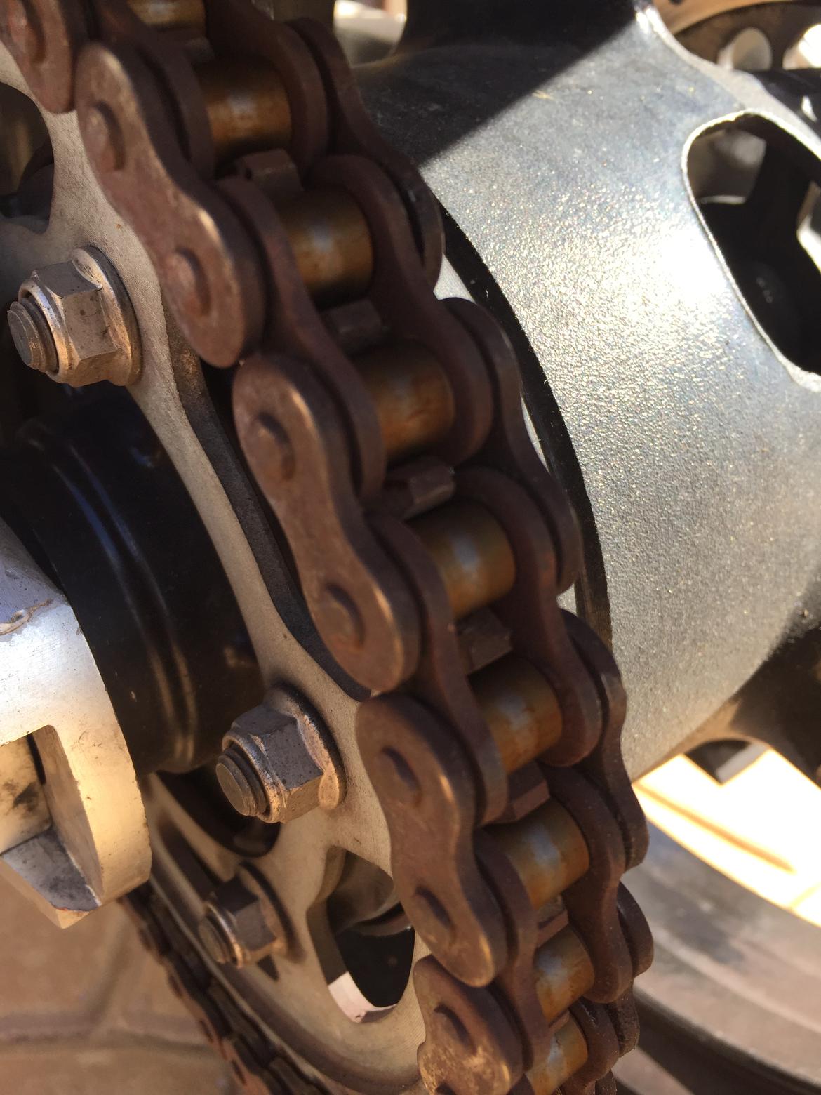

New chain also while I am at it
Already have the new chain and tires. Will see if I can break the bead myself or pick up a Harbor Freight bead breaker.

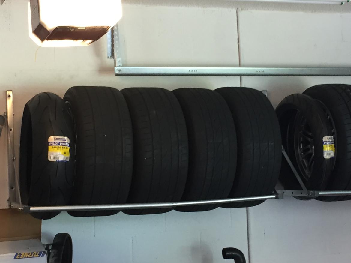

And the new tires are here as well:
