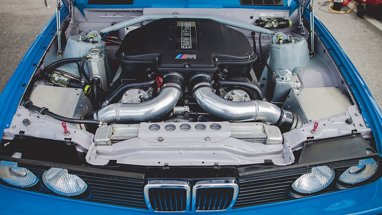

While the E30 looked great and had all the right ingredients underneath, it still needed the appropriate soundtrack. That’s where the V8 comes into play.
The build plan always included a V8, with the easy route involving one of GM’s Gen III LS engines. However, keeping with their plan, the shop decided to keep the car all-BMW and sourced a 4.0-liter V8 from a 1990s-era, E34-chassis 540i sedan. That car’s all-aluminum V8 engine actually weighs less than many of BMW’s inline sixes, including the one found in the E46-chassis M3. The V8 is also shorter overall, making shoehorning it into the small E30 engine bay a bit easier.
While this all sounded good on paper, in practice it did not deliver the intended results. After running that V8 for a while, the shop decided that its 282 horsepower wasn’t enough for such a radical build.
Bimmer Performance Center again went to the corporate parts bin and emerged with one of BMW’s best: the 4.9-liter V8 found in the E39-chassis M5 sedan. In stock form it offers 400 horsepower, individual throttle bodies and a 7000 rpm redline.
Inside its original home, that V8 could propel the 4000-plus-pound M5 to a sub-5-second zero-to-60 mph sprint while covering the quarter mile in the low-13-second range. Even a decade later, the E39-chassis M5 is still used as the measuring stick for all aspiring sport sedans.
Bimmer Performance Center rebuilt the engine while modifying the air intake, exhaust and engine management systems. Their V8 now puts down 420 thoroughbred horsepower and 390 lb-ft. of stump-pulling, Teutonic torque. The car’s total curb weight? Just 2800 pounds.
