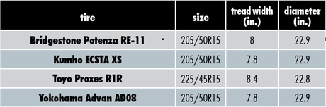

We also decided to add one more variable to the mix, the 225/45R15 Toyo Proxes R1R. While the rest of the tires that we tested last time were 205/50R15s, the wider size could be enough to give the advantage to Toyo.

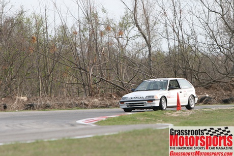

Our test procedure was identical to the last one, as we again had multi-time national champion Andy Hollis wheel his Street Touring 1989 Honda Civic Si around the test track at Driveway Austin. We even used the same course, including the seven-cone slalom as well as a good mixture of low- and high-speed sweepers. Each tire was shaved to 3/32 inch and set to its optimal tire pressure during our scrubbing-in process. The tires were mounted on identical sets of wheels, and each set took four laps around our course.
Since the Kumho was the winner in our previous evaluation, we decided to use it as this test’s benchmark. We first ran the Kumho, followed by the Bridgestone, Toyo and Yokohama. We then ran the Kumho an additional four laps at the end of the day to ensure that the conditions remained the same during our test. Once again, AXWare System’s Vitek Boruvka handled the timing chores with his super-reliable timing rig.

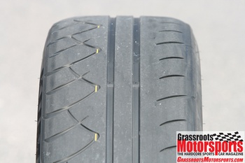

Kumho ECSTA XS
Mean Time: 35.032 sec.
Quick Time: 34.842 sec.
The Kumho ECSTA XS is an excellent tire, and our love from the earlier test was rekindled immediately. Corner entry was on the money with great turn-in response, and the tire really put down the power nicely when coming off the corners. Slaloms were also super-fast. In short, the tire repeated its stellar performance from last issue’s test.
The XS established a strong benchmark average of 35 seconds flat and a quick time of 34.8. The lap times deviated little from one another thanks to the Kumho’s unparalleled driving precision.

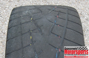

Toyo Proxes R1R
Mean Time: 35.356 sec.
Quick Time: 35.264 sec.
To put it simply, the 225/45R15 Toyo Proxes R1R is big and fat. Tires with wider footprints typically perform well in long, sweeping turns but struggle to keep up in transitional slaloms. The bigger Toyo isn’t a typical tire, however.
Thanks to awesome grip and response, it set fast segment times in our slalom. Unfortunately, sustained cornering was the Toyo’s downfall: The tire tended to overheat and fall off near the ends of long corners, limiting how much power we could put down when coming out of a curve.
During this test session, the Toyo nearly matched the Bridgestone’s times. The tire’s additional width seemed to make little, if any, difference in its final ranking.
