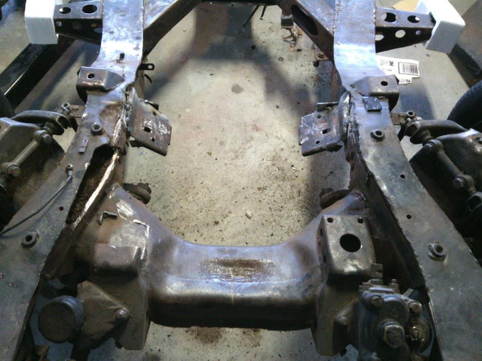

Step three: Clean the frame

More cleaning the frame and removing rust from the body. . .
For a lot of these boys this was their first time using power tools.  They really got excited when the sparks started to fly.  Even though the floorboards were horribly rusted most of the bolts on the chassis came right out without any problem.  That is except for one of the leaf spring hanger bolts.  One of the boys gave it all he had with an 18" breaker bar and the bolt finally snapped off.  This was odd because the rest of the hanger bolts came out easily, until I asked which direction he was turning the bolt.blush   So we had a good lesson on what happens when you turn a bolt the wrong direction.wink

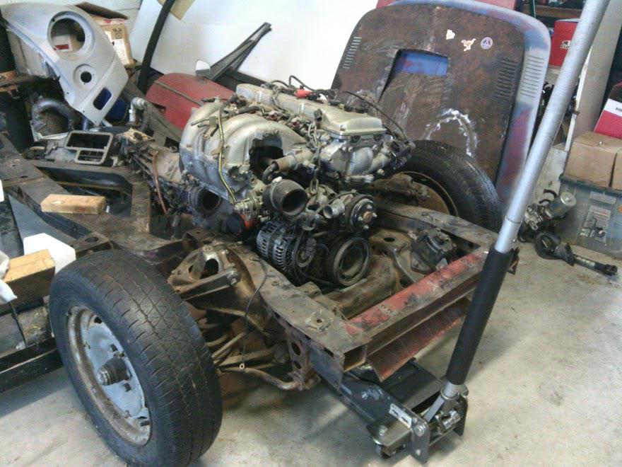

Before test fitting the engine and tranny to the chassis the boys installed a "White Bunny" clutch setup on the KA including a chromolly flywheel.  I'll have to check my notes, but I think the whole flywheel and clutch set us back around $150.
Then we had to find the proper location for the engine so that we could mock up the motor mounts.

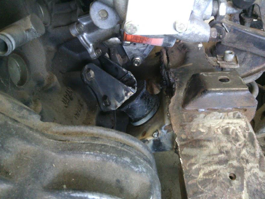

The original engine brackets were removed from the frame and then swapped left to right, moved back and down a little.  The front crossmember also needed a little "adjusting" to clear the oil pan and crank pulley, and the frame rail had to be notched for the alternator and oil filter.
For motor mounts we are using my go to for 4cyl engines, early 80's S10 mounts.  They run about $7 ea at Autozone. The engine brackets also had to be shortened and narrowed.
