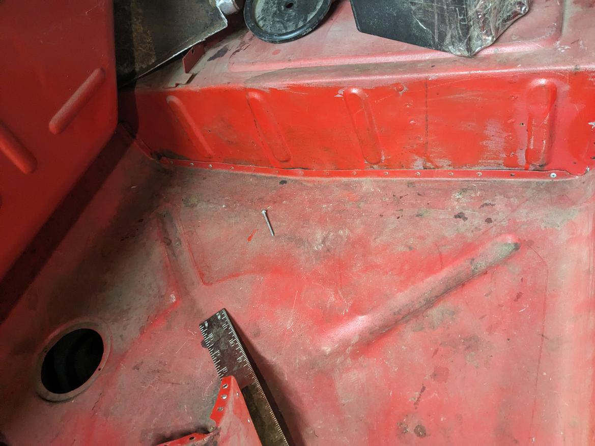

I jacked up the left rear that had sagged because of all the missing metal in that corner.  It was compounded by me cutting some out on the failed attempt to install the swirl tank.  Also, I didn't properly brace it when we last yanked the body off the frame, so it's sagged about an inch and a half.
Also, previous owner must not have owned a welder or something.  He pop riveted panels that should have been welded:
Indy - Guy
Indy - Guy MegaDork
4/24/25 9:36 p.m.
So, what do you guys recommend for the pop rivet situation?
1.  Leave it as is.  Good enough
2. Leave pop rivets in and add welding to the panels.
3. Drill out the pop rivets and weld the panels in.
4. Something even better I haven't thought of?
JoeTR6
JoeTR6 SuperDork
4/24/25 9:55 p.m.
If the panels are in the right place, I'd add some short weld beads to secure them, drill out the pop rivets, and plug weld the holes.  Make sure the body is straight and the panels are where you want them to be before welding.  If some things need adjustment, save them for last, drill out most of the rivets, adjust, clamp, and weld.
Those door posts in particular look pretty flimsy.
Dusterbd13
Dusterbd13 MegaDork
4/24/25 9:55 p.m.
Drill em out and weld in proper.
Recon1342
Recon1342 UltraDork
4/25/25 8:39 a.m.
Take the whole thing apart, reassemble with aerospace epoxy.
LoL.
Just weld it.
budget_bandit
budget_bandit HalfDork
4/25/25 8:47 a.m.
I guess it depends on how roadkill you want it to be lol. If it was me i'd probably weld it up
Crackers (Forum Supporter)
Crackers (Forum Supporter) SuperDork
4/25/25 10:30 a.m.
I'd want to know what other shortcuts happened, so I'd be tearing it down and reassembling, especially since it has a saggy ass. Undoubtedly they're related.
NOHOME
NOHOME MegaDork
4/25/25 11:11 a.m.
In reply to Indy - Guy :
The TR6 is a body on frame design with the torsional rigidity of a serving of  steaming hot Lasagna. The body panels don't bring much to the party. So if the Roadkill Ratsun look is what you are after, then just leave the rivets and  rust and move on.
The chassis on the other hand, has to be perfect on these cars. A known weak spot is where the diff attaches to the frame. It is a body-off job to repair  the diff mount and maybe even to properly inspect.
EDIT: Just recalled that this was an early car with the leaf spring rear suspension. So ignore last paragraph.
Indy - Guy
Indy - Guy MegaDork
4/25/25 1:49 p.m.
Thanks for the feedback and mostly confirmation for what I should do.
In reply to NOHOME :
This is definitely NOT going to be a build to the level of quality or finish that you or JoeTR6 typically do.  It'll be much closer to RoadKill style, but probably will eventually be all one color wink
When I first grabbed this, I was super excited that the base color was already Red.  But now, I would really prefer the whole car is a Flat Dark Blue.  Not sure I want to put the effort into changing the color at this stage though, so it'll probably remain red.
