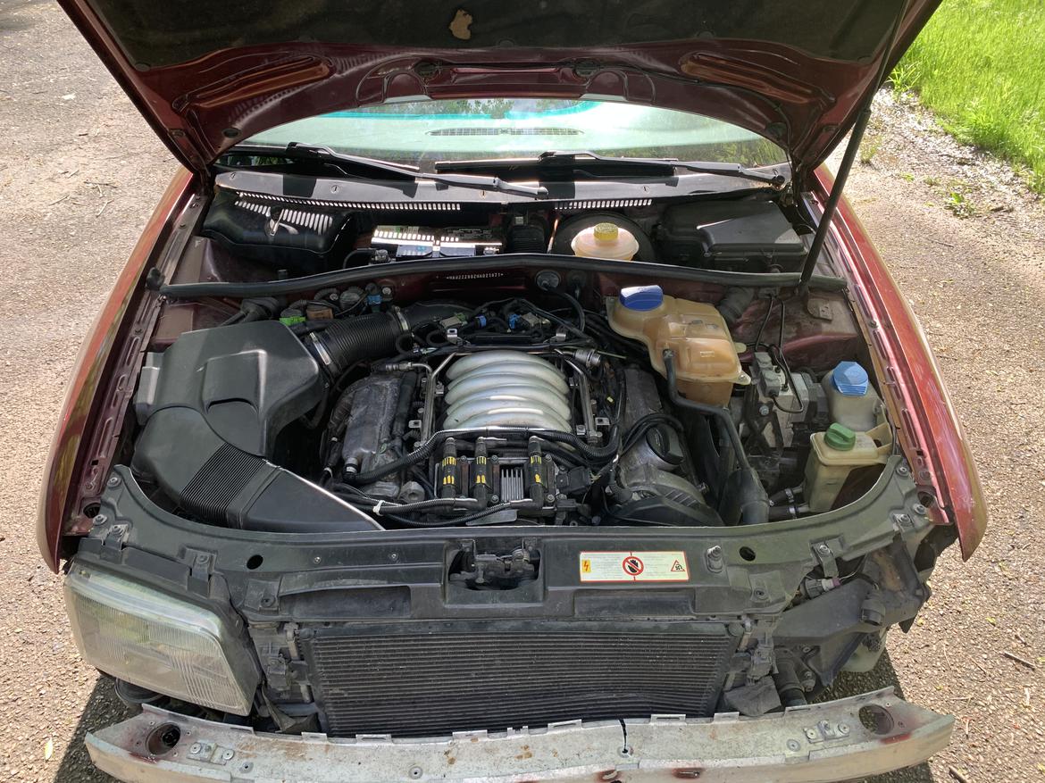

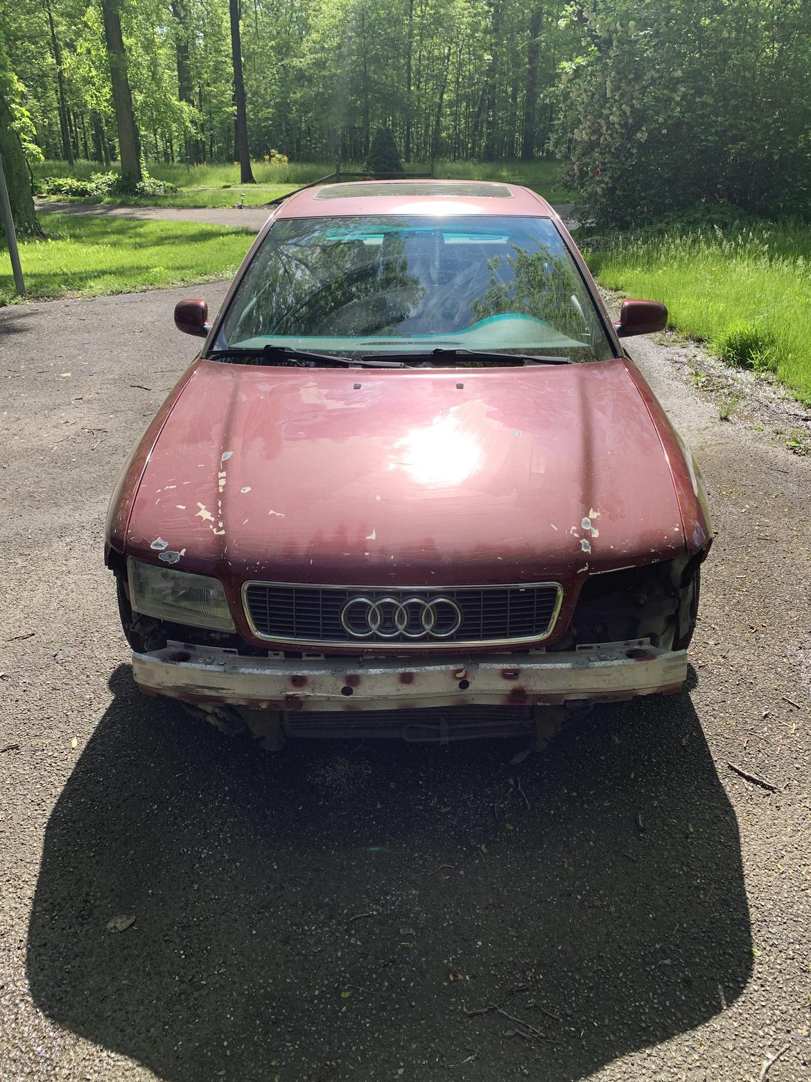

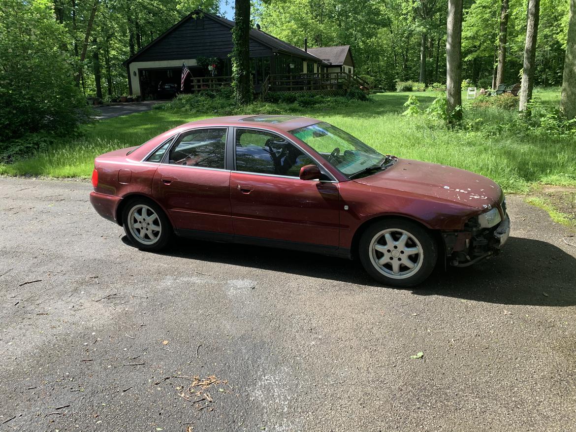

New to me car thanks to the overly generous brad131a4 (I don't  know how to tag people). Brad offered this for free on the forums, and before shipping, I asked if he would be cool with me stripping it and making it a rallycross car. I believe his response was it was my duty to "drive it like I stole it" hahaha. So we set up shipping and she arrived yeasterday. Here she is in all her glory.
1998 Audi A4, manual, Quattro, 2.8 liter, more affectionately known as "Ruby"
Ruby was in a little scuffle, and the left side suffered most of the accident damage, but she runs perfectly fine besides a flipped temp sensor that starts out pegged and cools down as the engine actually warms up!
Very heavy clutch (well, 90% light, last 10% is heavy) but drives well down my driveway: I can't drive her on the road yet due to lights and registration.
My plans? Get her road legal by replacing all damaged lights, strip it, see whatever "style" mods I want to do to make it look aggressive, and rallycross it!
I did a quick safety check- there's like ZERO rust, which is insane to me, and she looks very good in general!

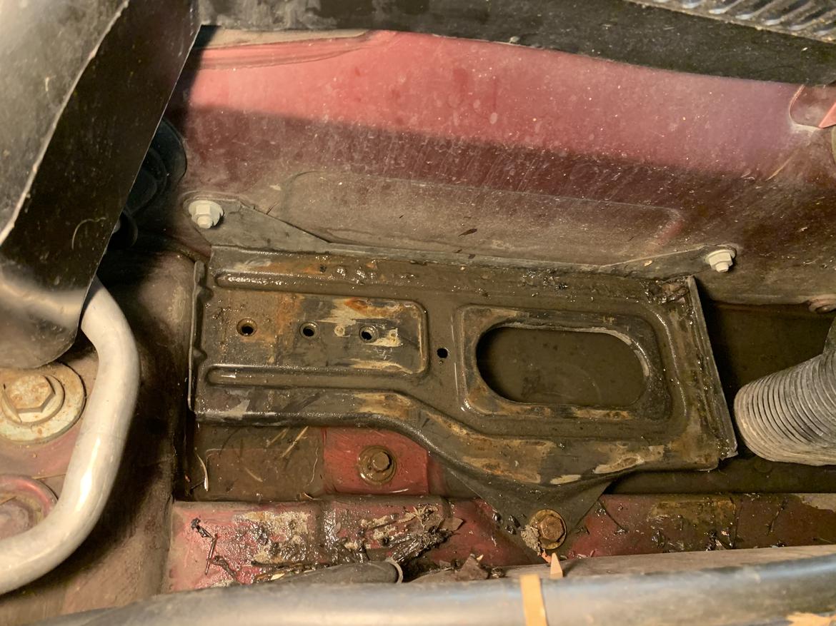

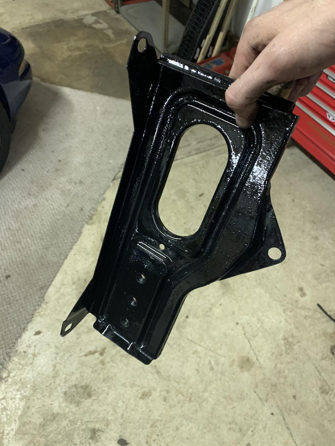

First order of business was fixing a lot of water in the battery/ECM/fuse box portion of the engine bay.
Remove battery and tray, drain (both drain grommets were clogged), paint with POR-15 since I already had a can open (and if you've ever dealt with that stuff, you know it'll only open once lol), and voila:

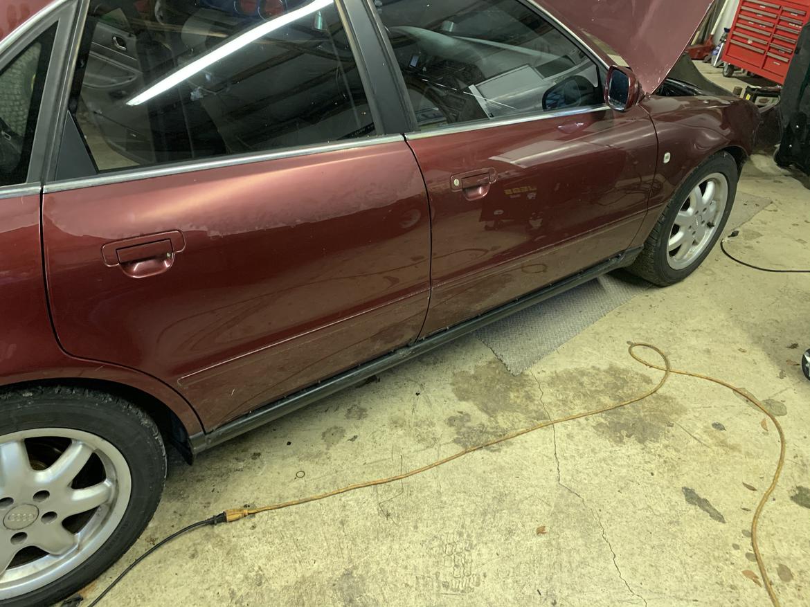

Ok, more time with Ruby today. Really starting to fear my to-do list as the other cars aren't getting attention lol.
My first order of business is to do no harm. So when I turned her on and got a "low windshield wiper fluid" warning, well duh, I took it out yesterday. So I found the wires for that (I have been labeling anything I remove), and spliced them together. No more warning, so that's one thing fixed, errr, "unbroken", really.
Next thing I did was paint: white for the wheels since rally cars all have white wheels, black for miscellaneous, and red for the car. I only did some red paint today.
Started with this:
Sprayed a little close matching paint with literally zero prep, and got this:
Then ground off half of the little door molding nubs
And painted:

Cleaned up more around the battery/ecm tray tonight. It was quite filthy.

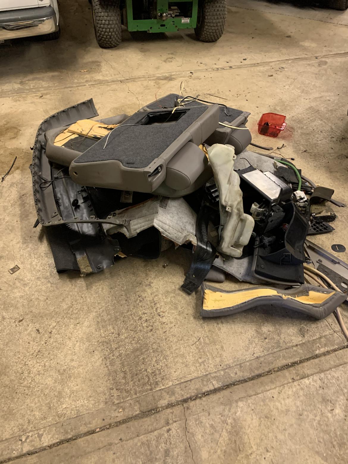

I stripped some more weight. Here is the running total:
There's probably another 10-20 that I hadn't bothered to weight also.

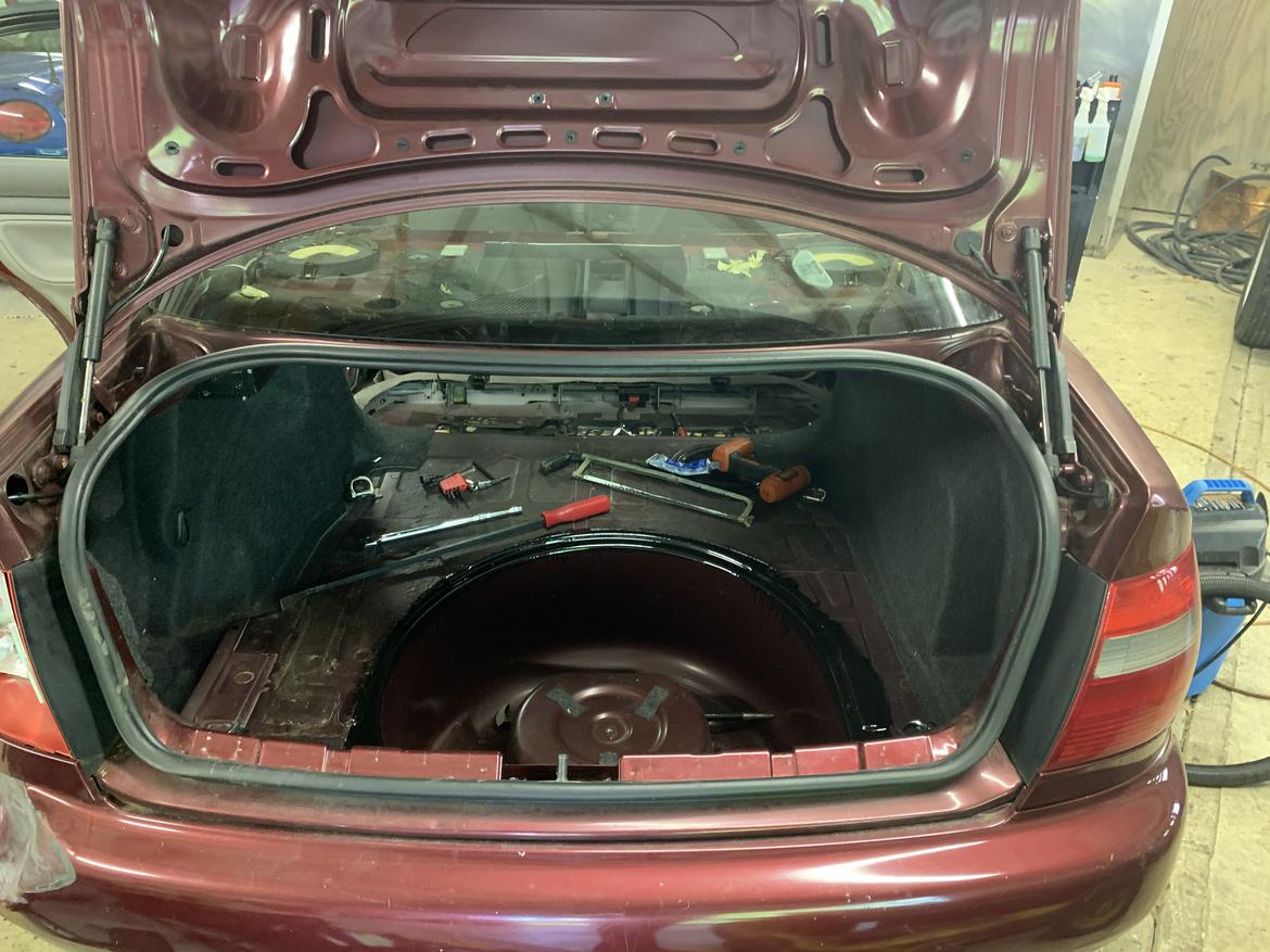

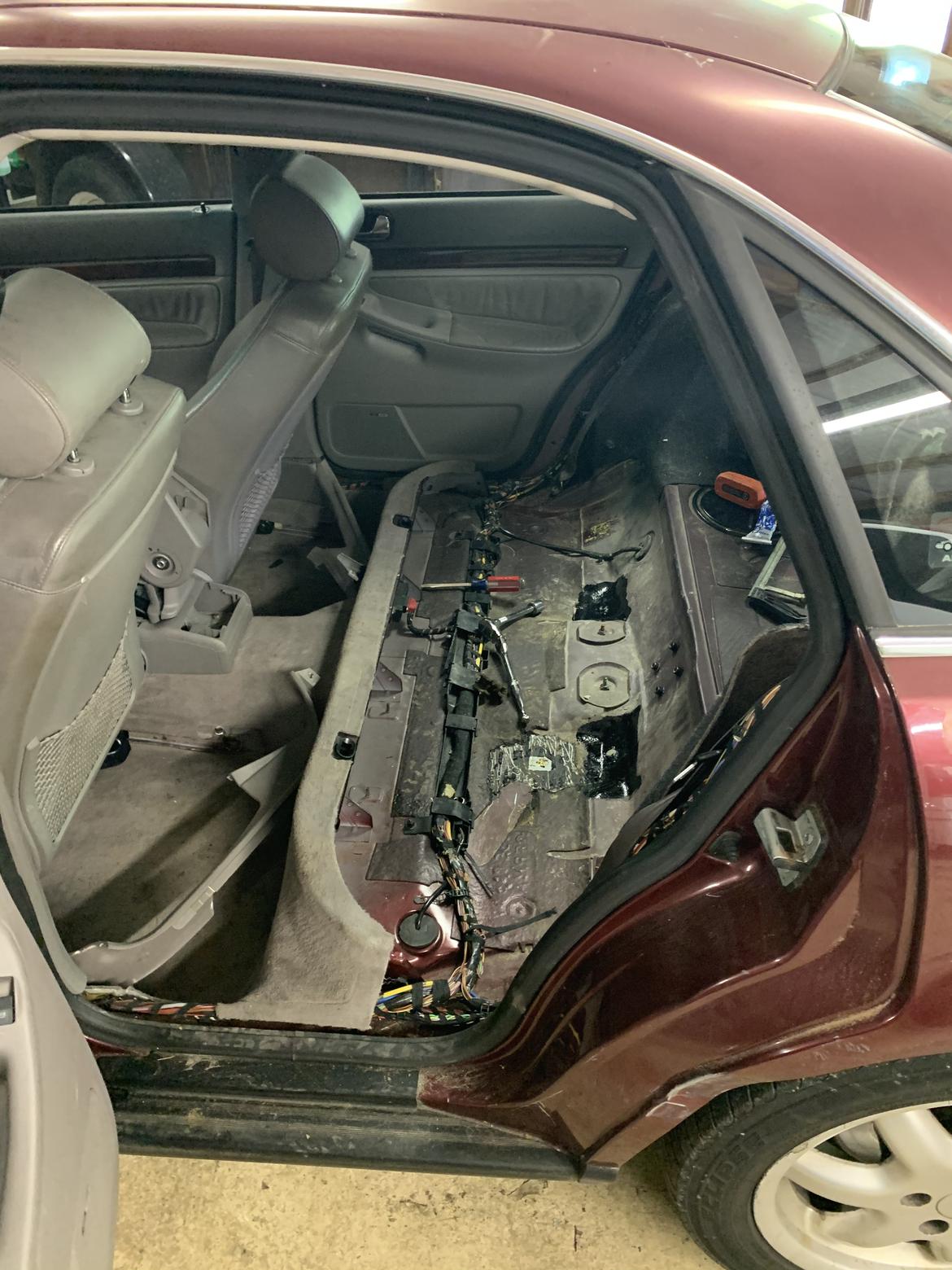

so, two questions- does anyone know what these two parts are?
This one is drivers side rear wheel. The lines snake up the fender liner but I haven't had the time to chase it.
This one is passenger side trunk, covered by a thick foam
And this one is driver side trunk- the part in the thru hole

I found what the driver side trunk part was when I pulled it and got a part number. It's an alarm horn. Well I don't have an alarm so out it went.
The piece in the passenger side trunk has vacuum lines running out of it- it is for the door locks. I unplugged it to see what else and it apparently reads of the clutch is depressed or not, so the car won't turn on without it!
That seems like an odd location for that lol, and weird that locks run on vacuum lines!
The lines running from the driver rear footwell are still to be determined.

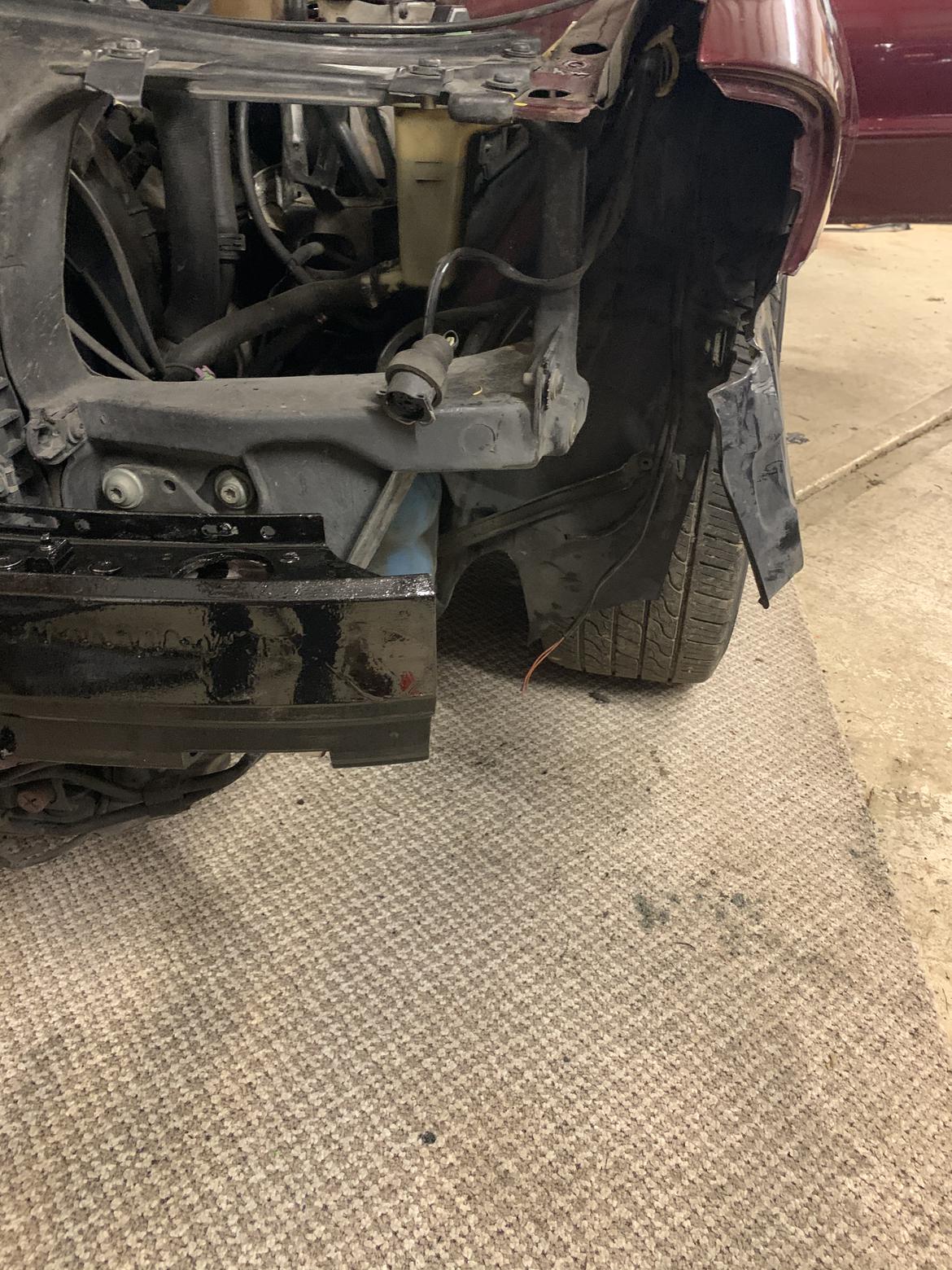

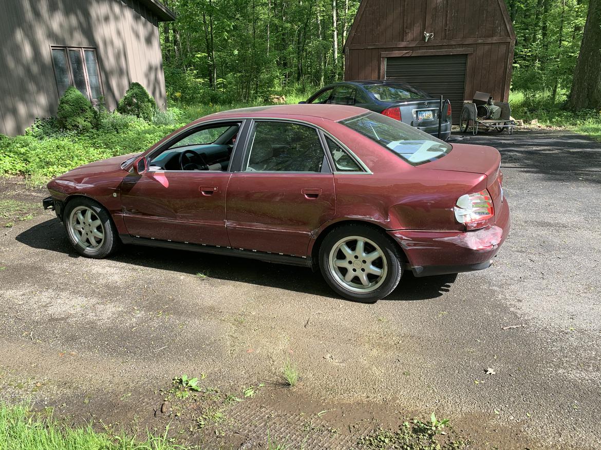

Next was the dent in the Ruby's rear.
started like this:
Pulled the bumper, cut some smashed internal honeycomb support, heated and hammered out to end with this:

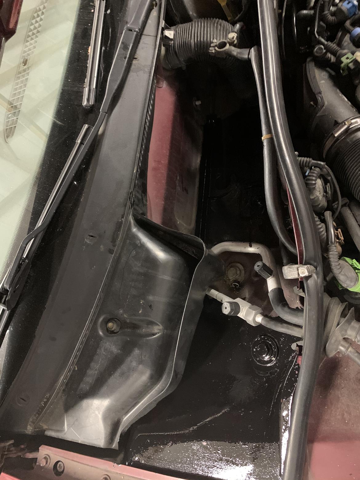

Quick update and plans for the weekend.
After 17 years, she finally got her udders milked frown
This is under driver side cowl. It is NOT my picture, but would be helpful to anyone in the future as anytime I searched this, everyone said there were 2 udders in this location. The one closer to the firewall seems to get missed a lot. If you can contort a little, you can reach them all from the top. I also got the passenger side tube, but NOTHING was in it, which is good.
Here's what came out of mine:
I am super surprised, given the low quality plastics used everywhere else, that these rubber (silicone?) hoses were as supple and pliable as they are. They felt new!

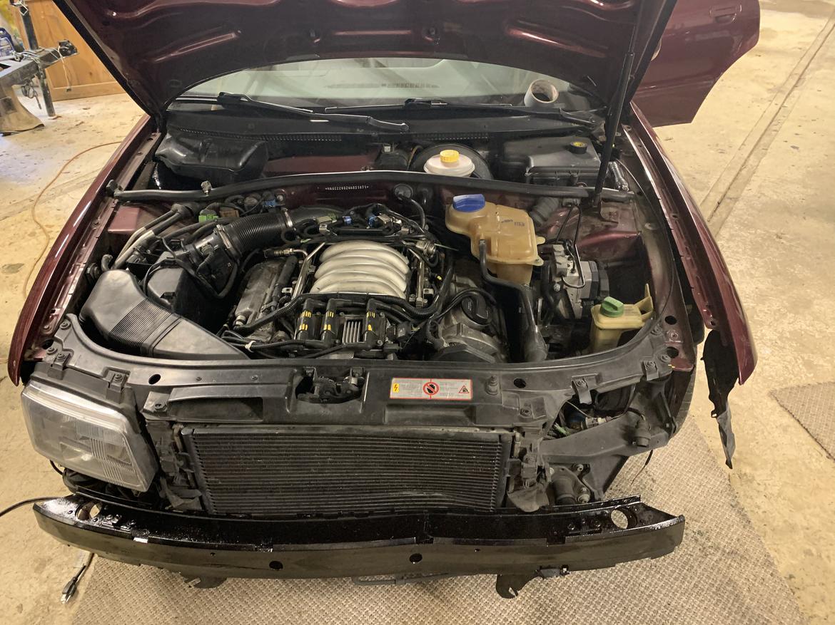

Got a little done on ruby. Just cleaning up the front end, rear end, got the rear light in, did some fender trimming. Nothing other than looks but I didn't have much time. Oh and painted the hood because race car.
front lights are on the way. Rears still don't work so I will try new bulbs first!
The radiator is bent, and so is the ac condenser. One CV joint is leaking but does not look torn- looks like the clamp is just loose.
On the corvette, and probably the Acura, I would fix them correctly. But this is meant to be beat on, so I'll throw a clamp and some grease in the boot. The car doesn't overheat just sitting and idling, also no leaks, so I'll leave those on until they die I guess!
