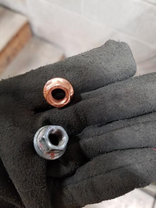

We lost a header nut during the last rally, so fresh copper ones it is:
Changed oil and air filter, spent a bunch of time cleaning dirt out of the various heat exchangers, hammered the skidplate back out, made fresh plastics:
Still need to heat gun the leading edges and tape them back up but it always feels good to have the car mostly refreshed after an event.
