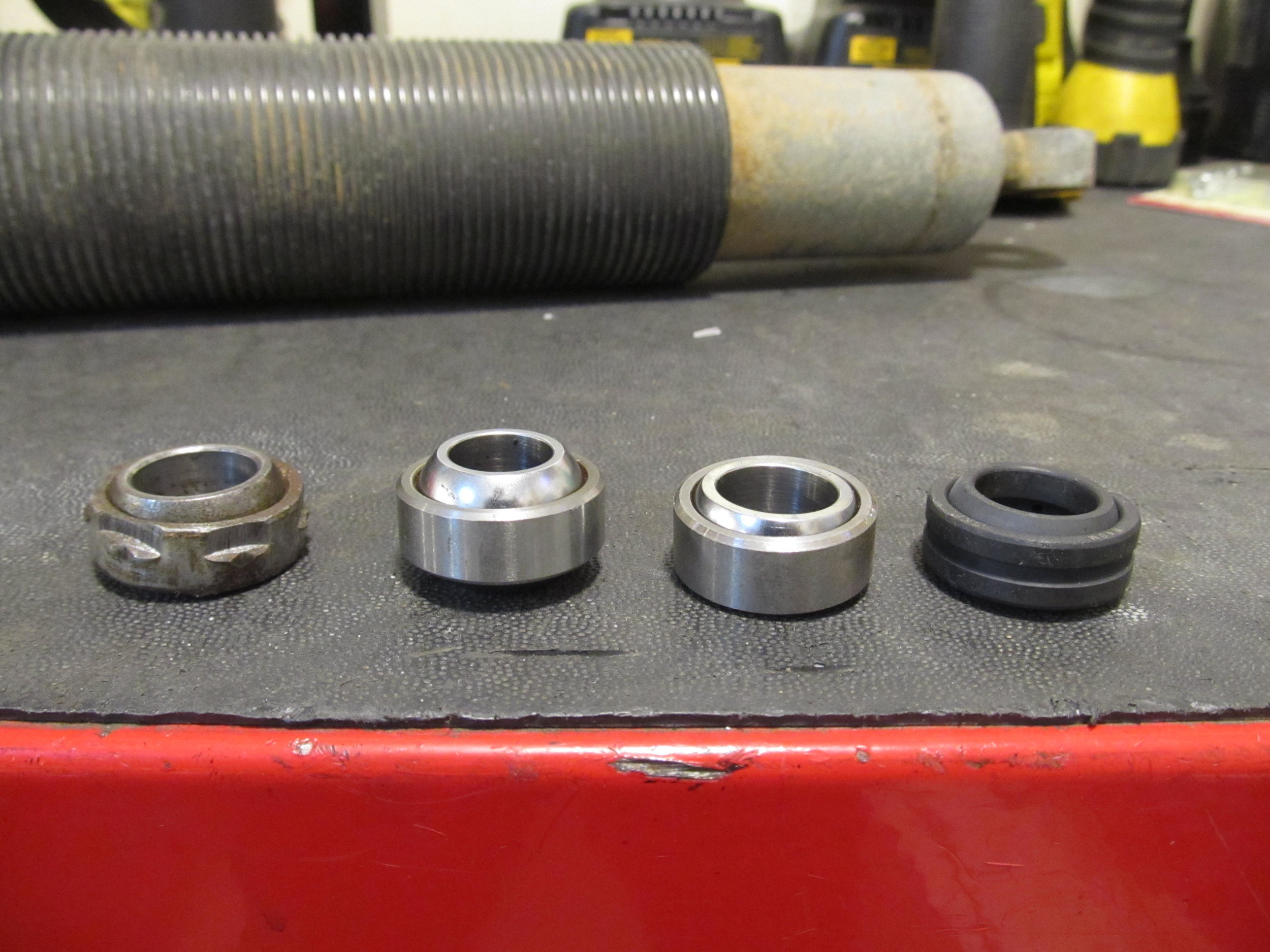

Here's what I'm working with. The original is on the left, the Bilstein bearing is in the middle, and the most recent one from RE Suspension is on the right.
Unfortunately, when I went to press in the new ones, they just dropped right in the hole with no need for a press. Turns out 0.6 mm is a lot when it comes to this stuff! Also, the outer race is too wide, making it impossible to reinstall the second circlip.
So here's my problem: the bearing dimensions for the bearing from Bilstein (center) are incorrect, and the outer race dimensions for the bearing from RE (on the right) are incorrect. Here's a chart summing up the problem areas:

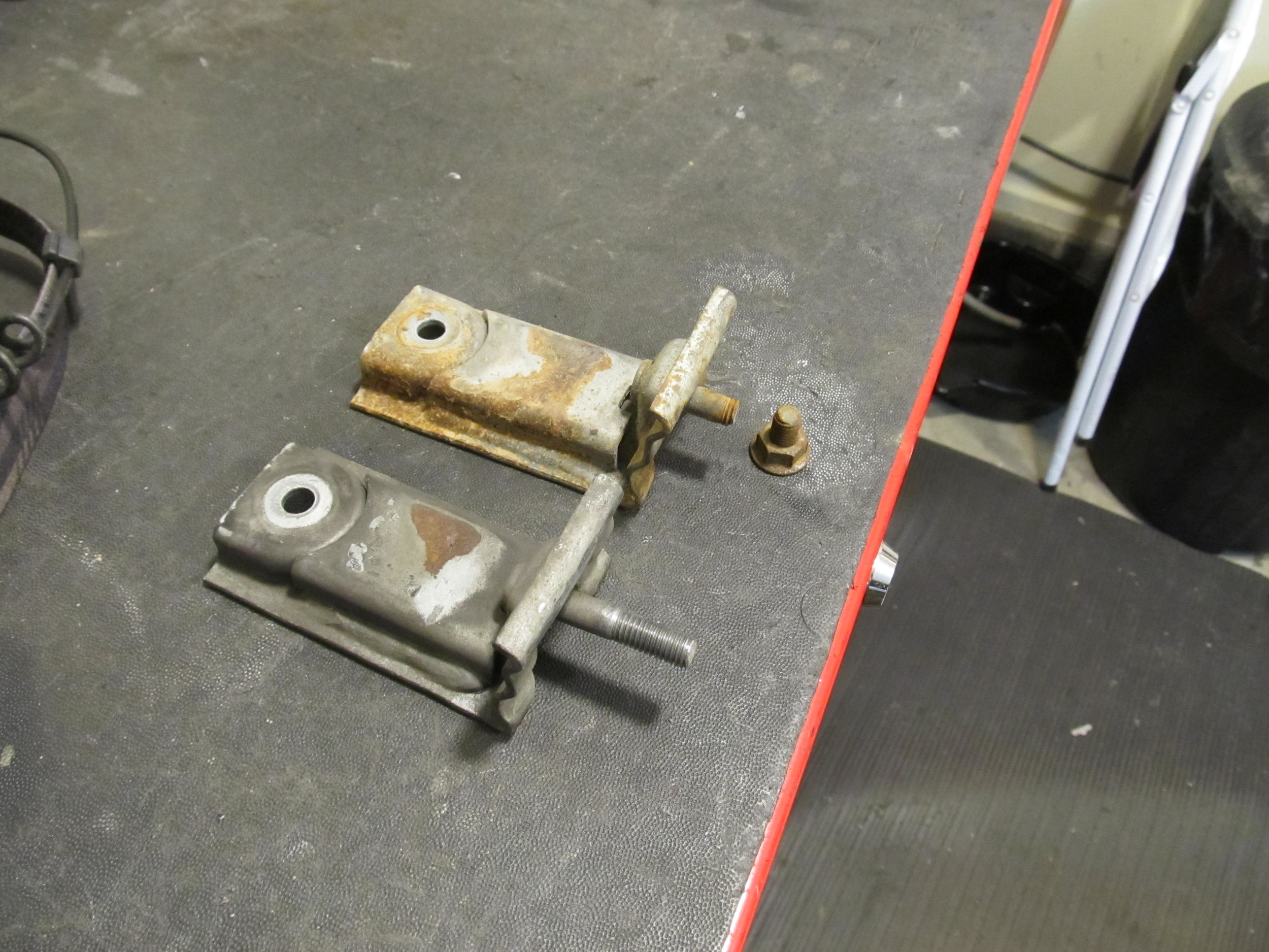

Making things more complicated are these spacers for each side of the bearing:
I have no idea if these were custom made or if they're an off the shelf part, but I need to use them.
I'm going to reach out to Bilstein and RE Suspension again tomorrow when they open, but I wanted to put this out here in case anyone knew of other places I should check. Please let me know if you have any advice on how to proceed. Thanks!

Sorry, I should have included some other info in my original post! So here's how it looks installed on the car with the spacers on either side:
The bolt there is an M12x1.5, with a diameter of 11.75mm/0.462". The ID of the spacers is 12mm/0.475". The ID of the Bilstein bearing is 12.72mm/0.5", which would allow too much play around the bolt if the reducing spacer wasn't used (which it can't be). When I showed it all to the owner of a local BMW racing shop, he mentioned that milling down the existing spacer wouldn't leave enough material on the lip where it goes into the bearing for necessary strength. But your idea of a shoulder bolt is a good one. But don't I need these spacers in there to allow the shock to swivel a bit? Or is that not providing any real benefit? This would hard mount the shock to the spindle assembly, which is I guess how it was stock. What benefits are there to having a spherical bushing there, allowing the shock to swivel a bit? Would I lose anything by hard mounting it and basically bypassing the utility of the spherical bearing?

With the help of Laminar on BimmerForums and Chris here on GRM, I was able to locate the proper bearings for my rear shocks! The PTFE lined bearings were somehow over $100 each, so I settled for a non-PTFE lined version for about $30 each. The vendor I bought them from assured me all SKF stuff is made in the USA. Well, he was mistaken.
Ok, fine, as long as it works I don't care. I then played with the bearing a bit and noticed how sloppy it felt in comparison to the other new bearings. It felt like there was as much play as the worn out ones! The finish was also completely different (on the right):

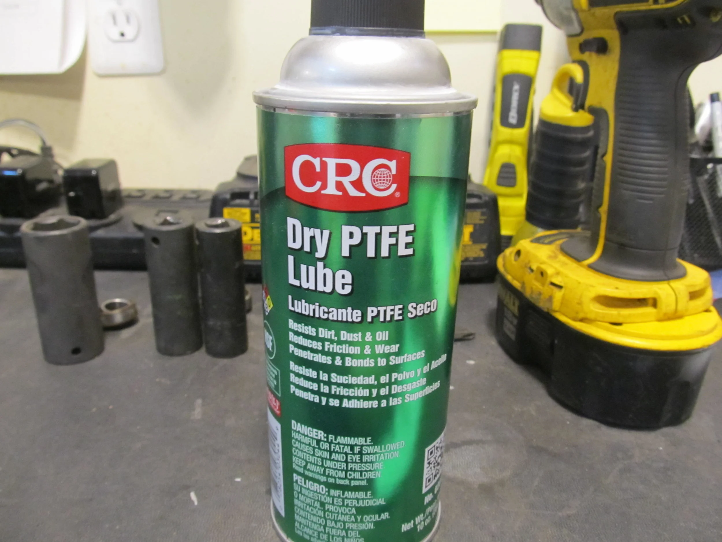

Thankfully the dimensions were spot on and I installed them in short order. I lubed them with a new product I bought with the hopes they stay lubed but won't attract dirt:

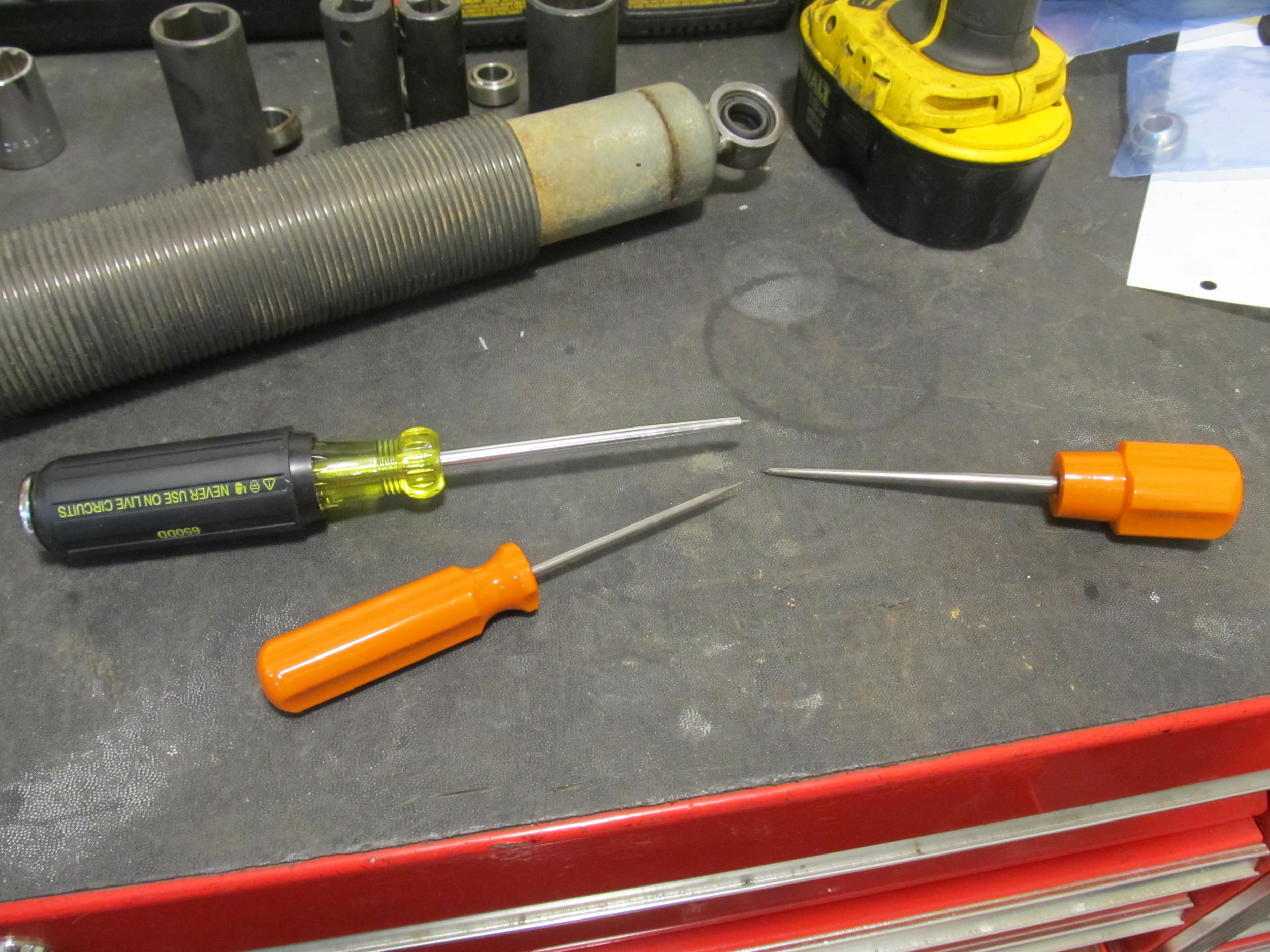

Removing the stupid circlips was made easy after I purchased a few different awls. These things are great!

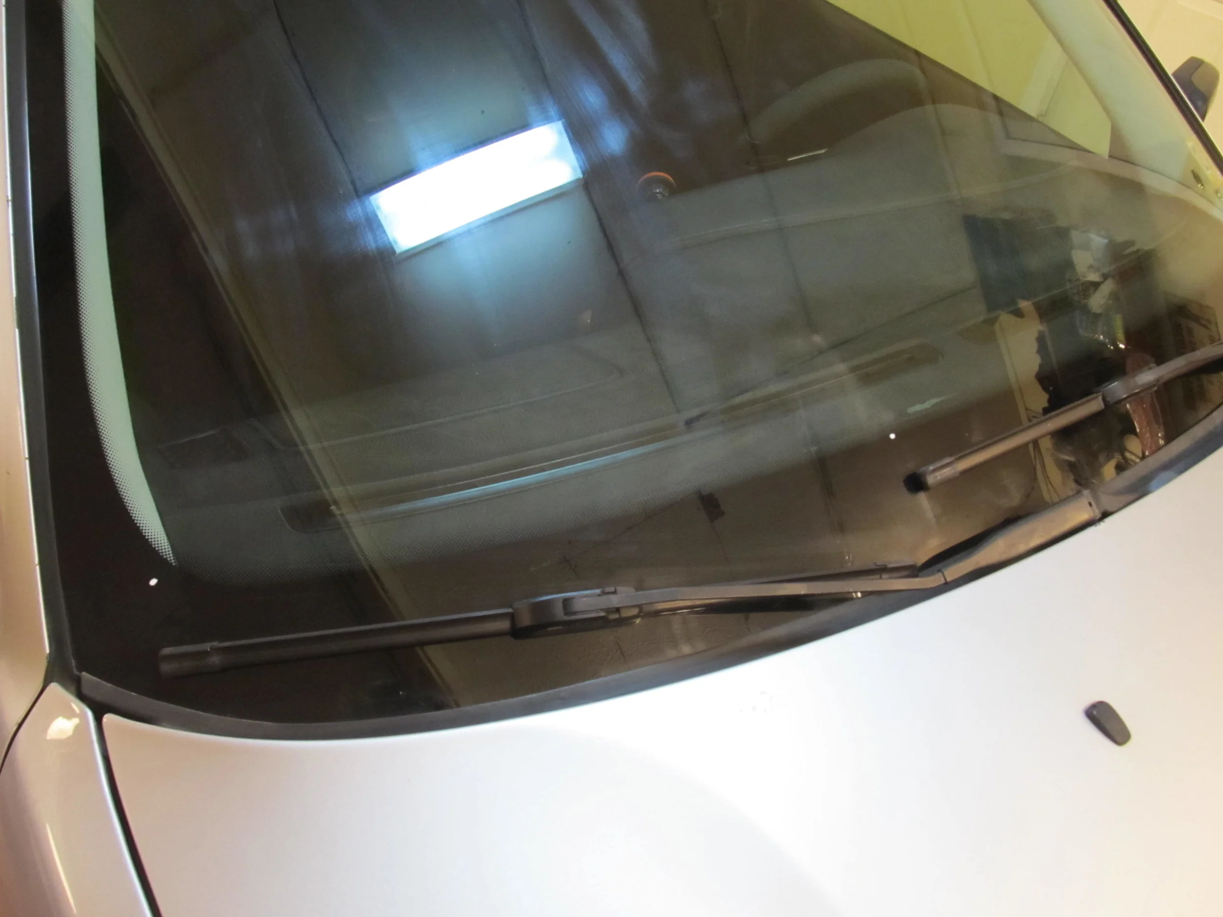

I also adjusted my wiper arms, since I got tired of the one on the DS hitting the A pillar every time it moved. Initially it seemed like I couldn't lower them any further, since they interfered when I lowered/raised the hood, but I decided to just press down and slightly bend the arms until they would clear the hood in their lowered position. Mission accomplished! The white dots represented the previous wiper locations.
