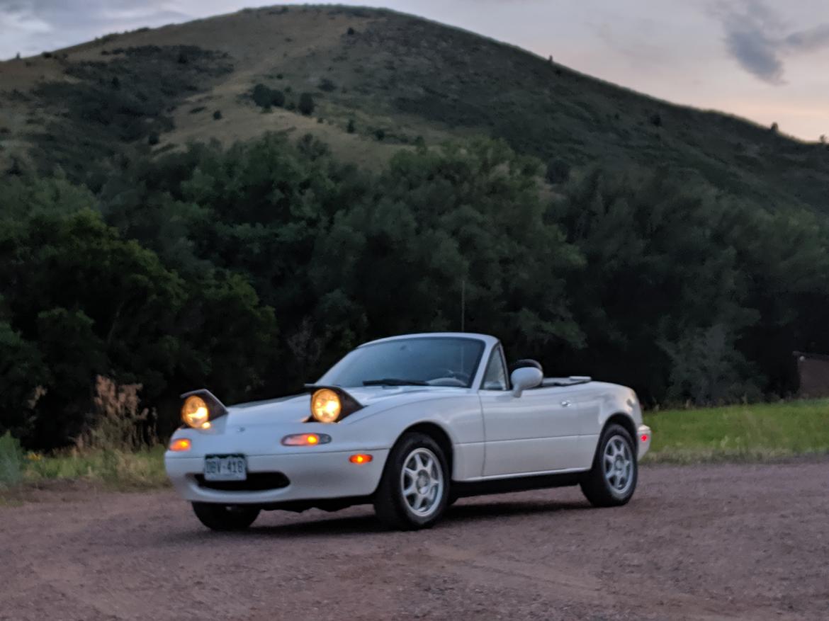

I really love this car too. The thread won't end just won't have as much autocross action any more. I just got my Miata on the road with new wheels, tires, and brakes and it's pretty much the greatest.

I just put a car up on BringATrailer.com so I'm shamelessly promoting it. I bought this little white 97 Miata from an acquaintance of mine who was forced by his wife to sell it :( my wife loves it but has trouble with the top so she doesn't drive it much and doesn't want to keep it. This car is amazing but I already got my black one ya know.
If anyone has questions please contact me through bringatrailer.com only.
