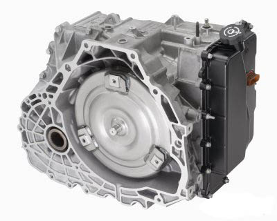

Car-Part.com lists two 2.0T EcoBoost engines from the 2012 Explorer in the $2000-$3000 range.
It looks to me like you will need a custom bellhousing on whatever RWD transmission you come up with. The current Explorer transaxle (going by Wiki and Google sleuthing, so I'm not positive) is in the 6F35. The Mustang uses the 6R80 automatic and MT82 manual (except Shelby).
6R35:
MT82:
The bellhousing patterns don't look like they line up at all to me (duh). The MT82 is totally off the table because its bellhousing is integrated into its case.
