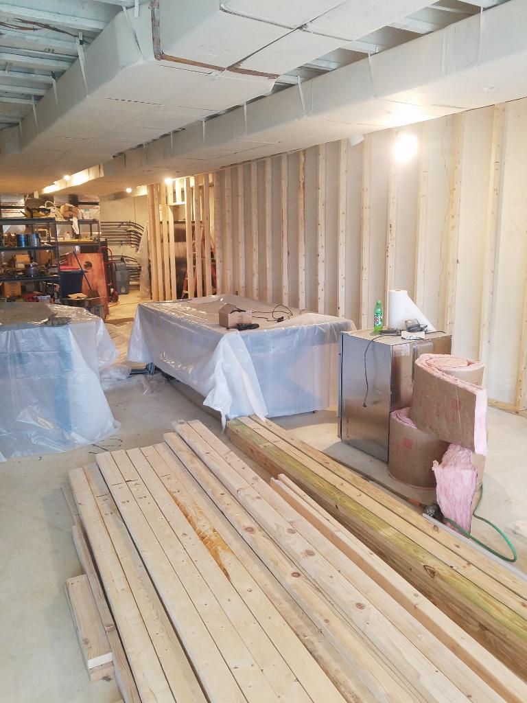

So I'm busy building the walls and bathroom in the basement she asked for while I wait for a few more bits of duct work to show up so i can do that work for her.

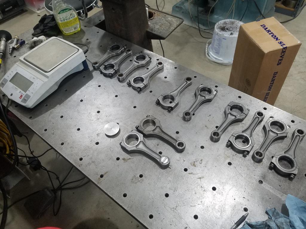

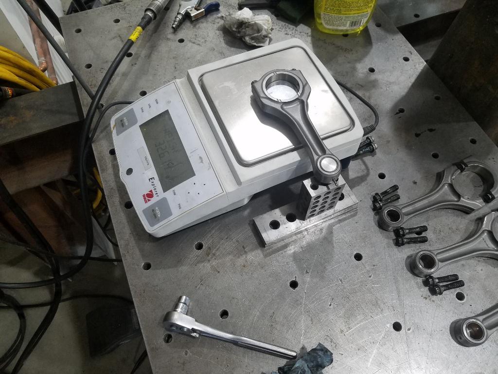

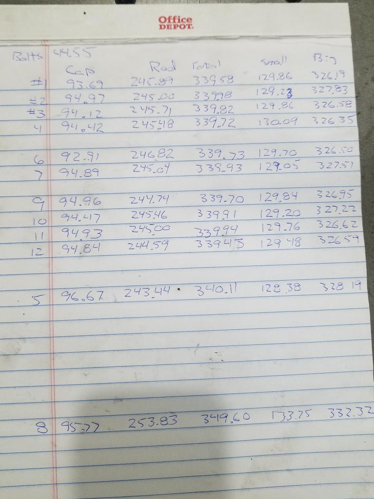

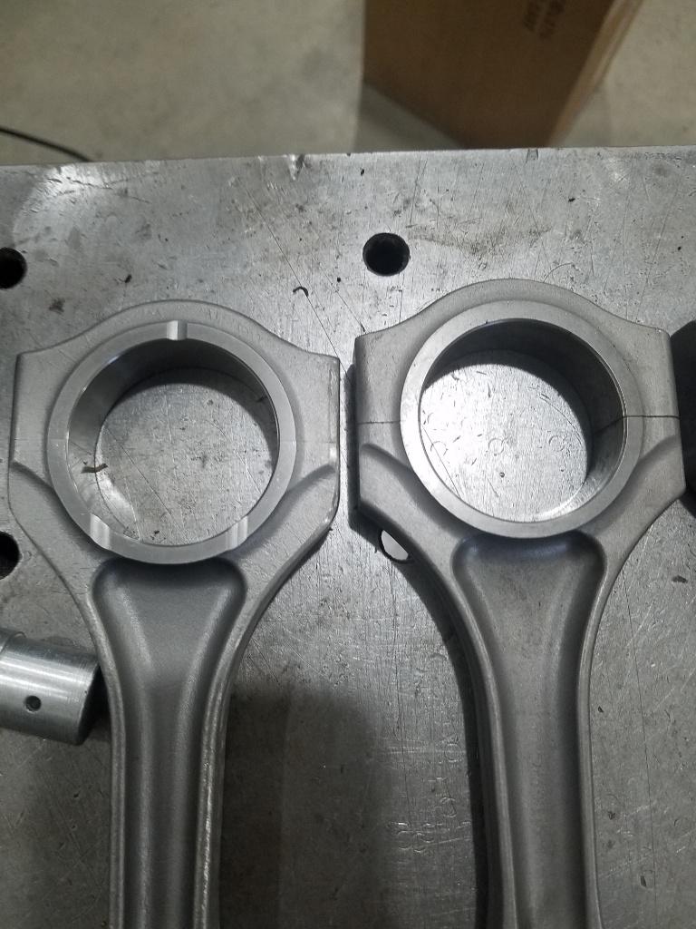

I decided to see what I need to do to make the 2 new rods part of the set so I weighed everything....the one is pretty light with the small end already about a gram under where I finished the others and the total weight about 1/2 gram over....and while I don't remember doing it it looks like I added oil grooves to the the others so I'll need to do that and probably make this new rod the lightest in every way in the process :(
About 10g to come off the other so that one will be easy to deal with.

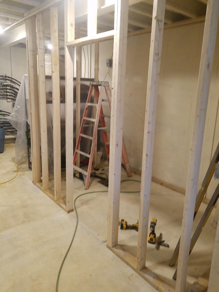

Sorry just a building person here. Are you using pressure treated lumber for the bases of your walls? Also if the cement wall is in contact with the outside dirt a plastic vapor barrier is needed between it and the studs. Just my .02 take it as needed. As for the car that's way over my pay grade in fab work.
mke
HalfDork
3/28/20 6:40 p.m.
Yes, pressure treated on the concrete. We went round and round on vapor barrier and finally settled on no
Do I need a vapor barrier?
We have a french drain and decided best to not touch the wall, any water ends up I. The drain, moisture can dramy to the inside....in theory
