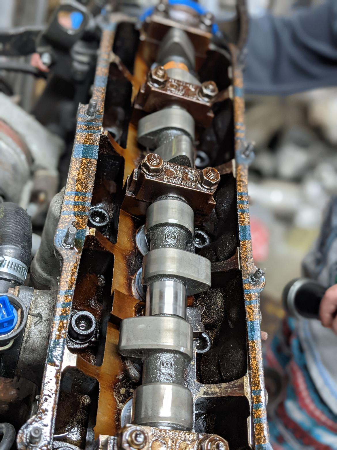

Keeping the kids busy, I had them help me break down the 8v that came out of the Fox. 3 Center mains and all 4 rod big ends were fine. The bearings are all tired but none spun. Top end looked fine, little dirty but not 'I sound like a bag of rocks' dirty. We also realized the crank pully was loose and the keyway was blown off of it. Im not sure what broke on this motor first, but a number of external parts all seemed to let go. Some good news however it looks like we can strip and save a number of the core parts I don't need for the Fox and keep aside as spares for a friends MkII Rallycar.
