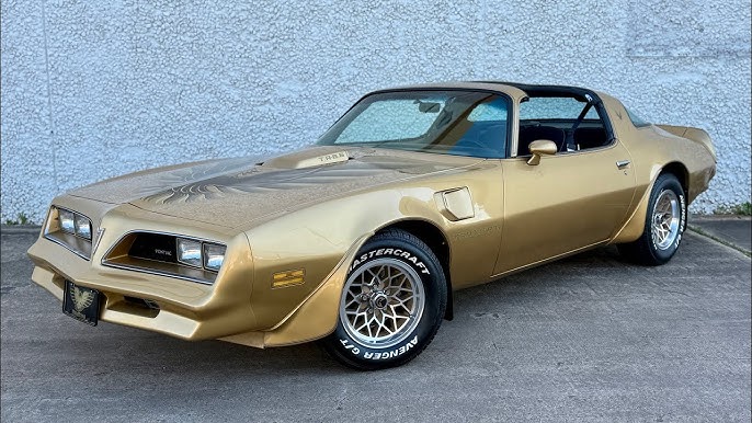

I looked into the M/T Sportsman tires, and they are almost as much as the BFG's. If I'm going to spend that much, I'd just go for the BFG's. I was hoping to get something cheaper that holds air and won't kill me, so no weirdo tires like the Tornel Direccional or Gripmax Max Grip or anything like that.
I think I settled on the Mastercraft Avenger G/T; they are around $140/tire. They are essentially the same tire as a Cooper Cobra with a different name (Cooper owns Mastercraft). Eventually, I want to upgrade to 17x9 Snowflake wheels to get better, modern tire choices, but these will do for now. They look OK on the car, I think:
