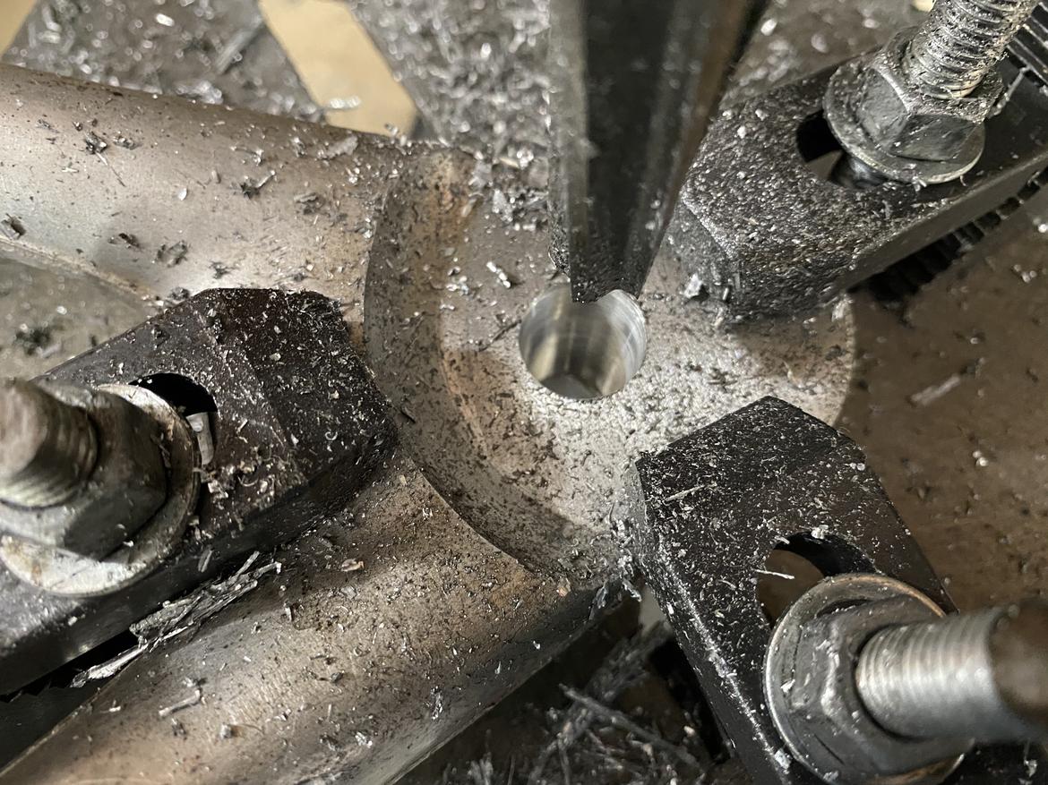

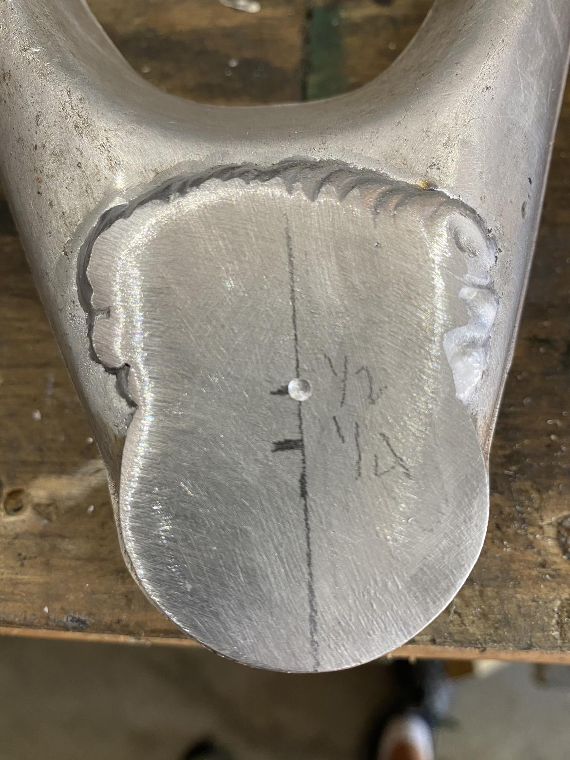

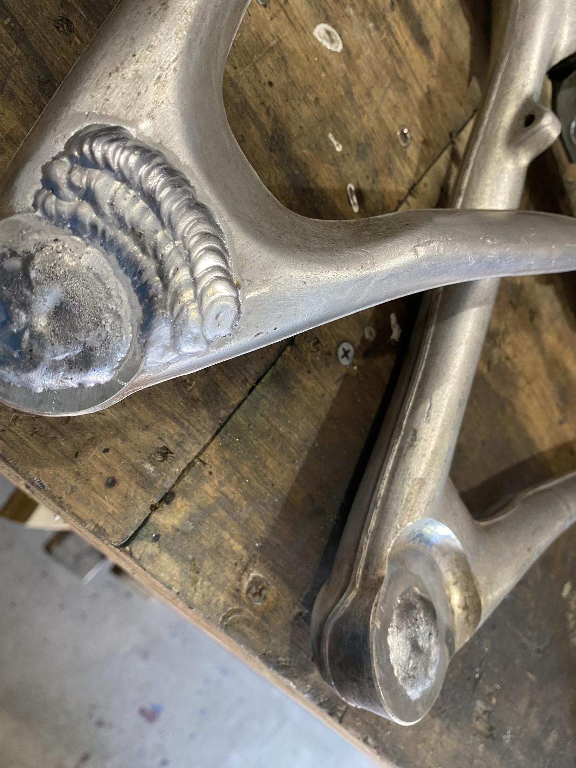

front upper arms progress. My autocrossing, picturing taking, tig welding buddy filled the holes yesterday and i punched new ones today.
Moved the hole inboard 1/2". By my seemingly simple math (tan formula) that should net a bit more than 5 deg of potential neg camber.

Can you give me details on the a-arm welding?  Did they get pre-heated?  What TIG rod?  Post heat-treatment?

Yea, i did a thread when we did the rears almost exactly one year ago. The fronts we did the same way. no heat treatments, used the same ER5356 filler.

Cool.  Thanks for that info.  Did you pre-heat the parts before welding?

No, he put quite a bit of heat into it with the tig prior to adding material, but we didnt take a torch to it. Overall, it go hot enough that you could smell the bushings at the other end,,,,
so is there a tapered plug that gets welded into the original hole?  or is it just open up the angle of the original hole from both sides and fill it with molten rod?  i could see this being beneficial on my C4 front uppers. you know, for the 2026 Challenge.

Its the latter, opening up the hole to get the tig torch into the middle area. Use large drill bit to open it up quickly, but if your shooting for '26.....

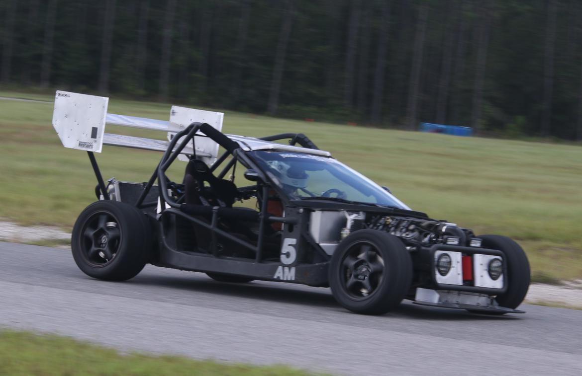

9/15/20 11:47 a.m.
Ran the kart at FIRM on saturday with Jax Solo. Pretty happy with my fairly consistent times. Kart was super loose with the rear bar connnected, new front tires didnt help that condition.. but front grip was superb. DIsconnected the rear sway bar after my third or fourth run and it felt much better. Got 9th overall raw time behind a GTR, GT4, M2 and a couple 1LEs and C7s. Not bad company for my pile.
Some guy named JG took a bunch of pics, thanks JG!!   They showed a shocking amount of body roll... i have been running my base C5 front and rear bar, but will be going back on the Z51 front bar for the next event.

10/5/20 10:36 a.m.
Indeed, Oct 3 was worth looking forward too!
Certainly the best finishing position for the kart to date.
Placed 7th overall raw time. 97 total drivers.
Ahead of me, only two cars with doors. One our clubs reigning overall champ in a GTR. The other car, a new Supra piloted by two of the biggest names in autocross. The slower of which on saturday, was on the cover of SCCA magazine last month. The other 3 spots ahead of me were Stalkers (lotus7 replicas) on slicks, again well know cars and drivers regionally and nationally. Good company for my junk.
Comparing times a few of the clubs consistent drivers from the FIRM event in Sept to this past Saturday, with my times, it appears i gained about 1.5sec against the competition. which, of course, is huge. I think it was all setup. I was on the same set of tires, same pressures.  This month i ran the Z06 front sway bar (previous base bar) and left the rear sway bar connected for all the runs. i also ran with the wing in its more vertical orientation.
Going to stick with this combo!
