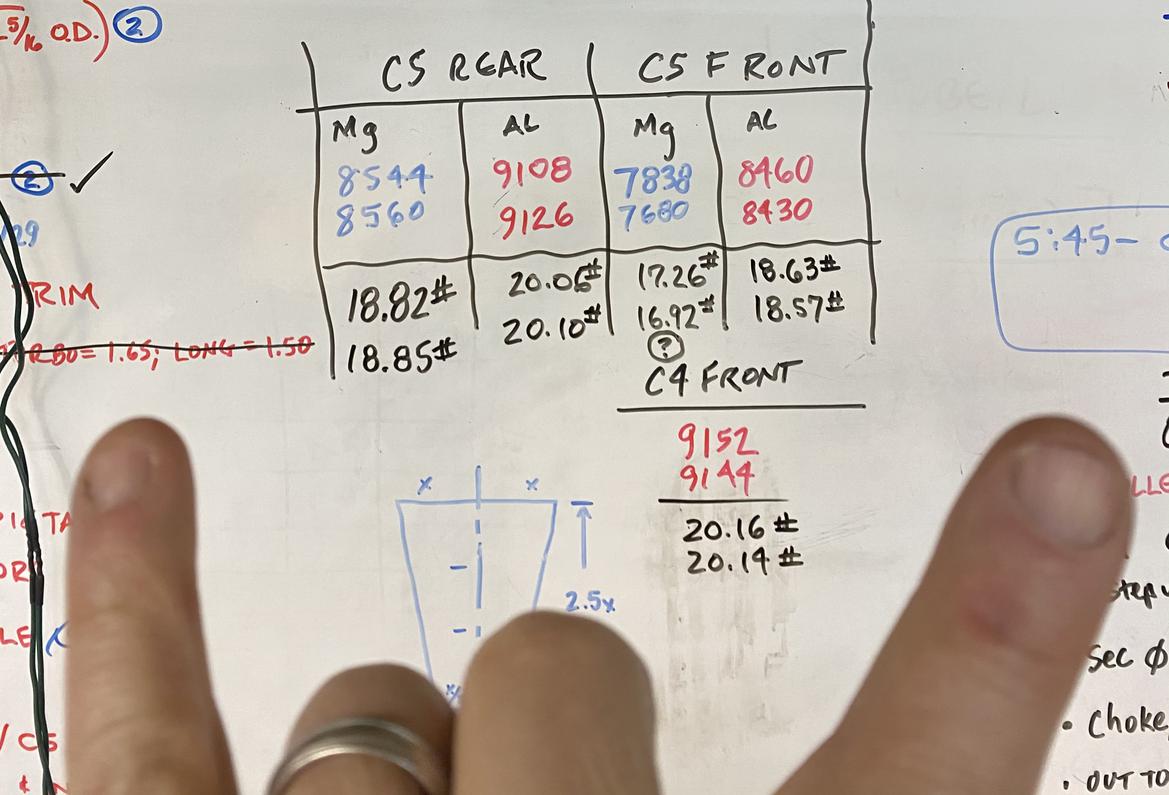

Wheel weights by type and size:
I was surprised to see the difference in the two C5 Mg Fronts. I have a bunch more of them to weigh, and I'm curious to see the variation in a larger population. I weighed each of the above twice, so I trust the numbers.

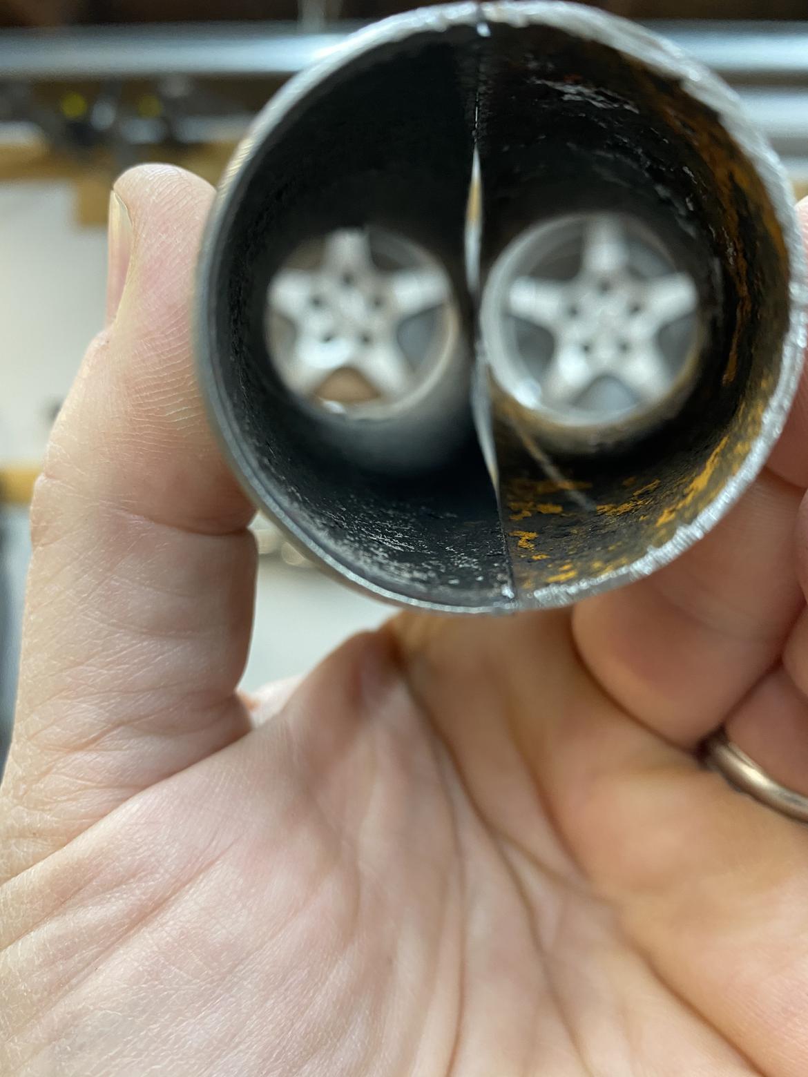

I also played around with making a merge collector for my primary tubes. First I did a little math:
Then I marked the tubes and ran them through the band saw:
This is just a practice piece to experiment with the band saw. I am encouraged.

I need a Bridgeport. Cutting the tubes to make this one piece took way too long. And this is just a practice piece.
You get used to it.
