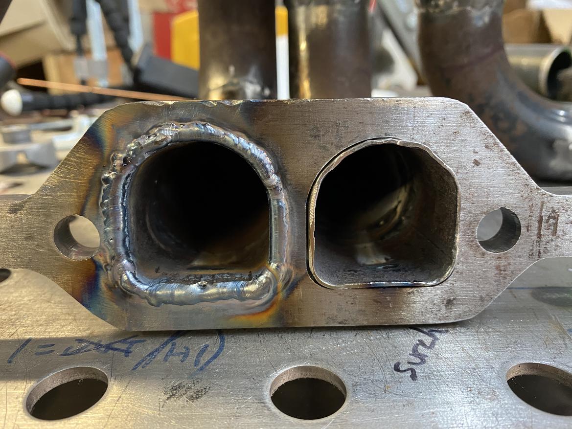

So even when I'm not rage welding, the results are pretty terrible. I'm tired of working with junk. Need to get these headers finished!

Your welds have been amazing, over all. That last picture looks more like my good welds!

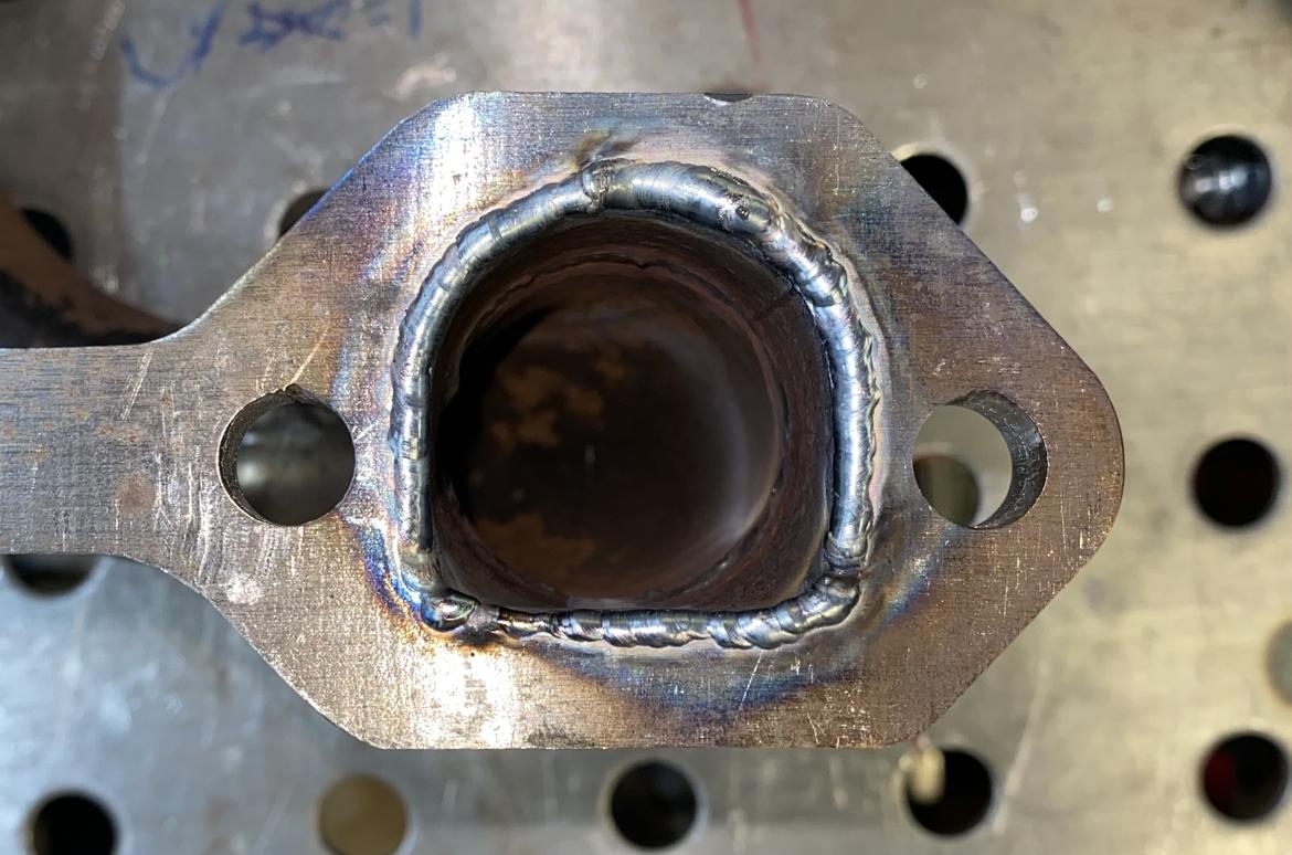

now with 100% reduction in rage. And perhaps this belongs in minor confessions, damn I was nervous about blowing through here and throwing away the last couple hundred hours of work.
second verse, better than the first:
.045" filler and less heat, focusing on keeping the torch on the flange side of the weld line.
Mr_Asa
Mr_Asa UberDork
6/6/21 3:35 p.m.
Nice work, my man.  Gonna do the other side as well, or just leave it as is?

0.045" filler was a huge step forward on the for the thin materials I find myself working with recently. I have been know to use stainless saftey wire for thin stainless too.
Thanks! I'm going to do a little on the other side for added strength. Torch access to top of ports isn't good, and I have to be careful on the sides to stay away from where the bolt heads will sit.

You may want to look at brazing rod for the outside of the joints. You have the tubes welded to the flanges inside, now you just want to add some reinforcement to the outside. The brazing rod will fill the gaps. Otherwise, leave the area near the bolt heads unwelded.
That is a very solid idea.  Nice.

Brazing isnt welding.  Temp is too low and it has dissimilar metals being joined
I would think you'd need a propane or MAPP torch to use brazing rod.  It still requires flux to flow in order to get a good braze.  Could be wrong, though.

What I do is weld the inside the flange with stainless rod and use silicon bronze filler rod with the TIG on the external flange side of the joint... obviously on stainless tubing. You could use mild steel rod inside on regular steel headers and silicon bronze on the external side.  Reason for the silicon bronze is flexibility in the joint and keeps more heat *out* of the joint when welding as well, as its a much lower temp process, so it helps with negating "over penetration" for lack of a better word, and effects thr heat effected zone as well, by being much smaller with SilBronze... so its much less prone to cracking.

Those are pretty damn sexy, my man.  From the weld pattern it looks like you didn't need to use flux?

Thanks much.. and none needed with a silicon bronze filler rod designed for tig. Stuff works great. We use it all the time as well as on our turbo headers on the external flanges as well.  Everything is back purged as its all stainless, but on mild its not necessary.

I knew difference in expansion rates would probably make welding both sides a not so good plan. I would hone never thought of brazing the outside. Brilliant!
