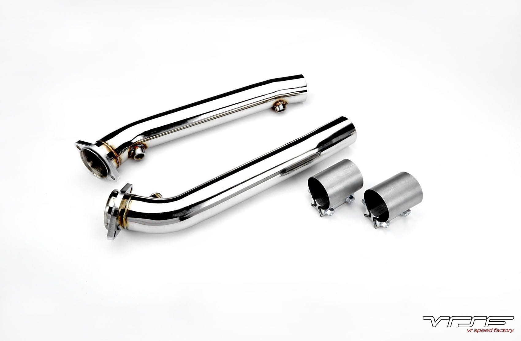

The cats are removed and laid next to the new VRSF test pipes. I also always lay the oxygen sensors in the orientation they are installed in the car, so that they aren't accidentally mixed up side to side.
On my prior couple cars, I ran catless exhausts and eventually got sick of the smell. On the M3, I wanted to enjoy the easy power gains of test pipes, but wanted to have something reversible in case the smell got to me (and my wife/daughter). I started with some VRSF test pipes, since I knew I'd be cutting them up.
The test pipes were trimmed and fitted to 2.5" V-band connections for easy swapping later on in case I wanted to reinstall the stock cats.
Lots of mocking up and tacking later, followed by finish welding...no pics here, I just got in the zone, turned up the music and cranked it out.
No stacks of dimes here but my welds are strong and functional.
Buttoning up the underside with the undertrays, ran into a small snag with the oxygen sensors.
A quick trim with the death wheel made adequate clearance on the heatshield and it all went together nicely.
