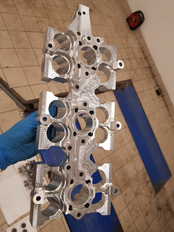

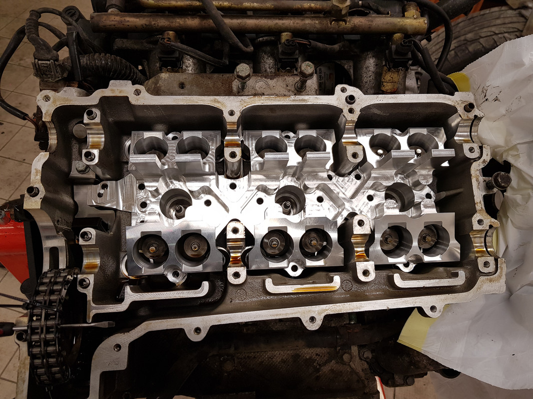

My partner in the engine project has installed our billet tappet chest in his engine to test it (it's otherwise stock):
We're sticking with the stock seats as, when we measured the 3.6 head, Porsche did space the (larger) valves further apart, so we don't want to risk there being insufficient material in the 3.4 head to support the larger seat and associated 40mm valve, so 38's it is. That's 1mm larger than stock, and allows some very useful re-profling of the seat.

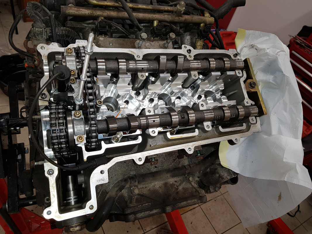

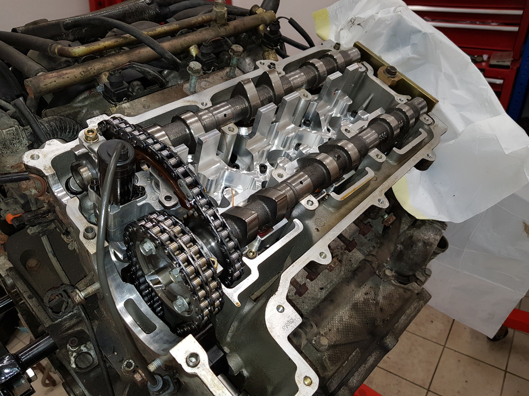

More from my partner in crime, all bolts torqued down:
Camshafts and VarioCam actuator in:
Waiting for the sealant to turn up in order to install the cover:
