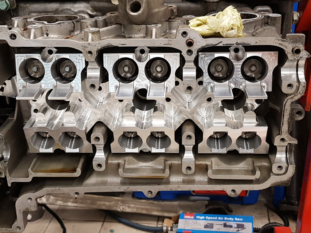

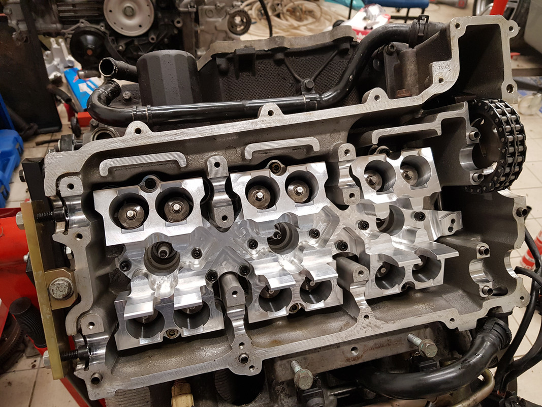

Slowly making progress:
We have clearance with the stock rods, but we're not getting the squish that we want, and we need to check CR as we need to raise it half a point or so from stock - so longer rods are in the future. This does mean that we can use 300M, and aim for the rods to be as light as possible. Pistons will also either need to be heavily machined or we will need to start from scratch in order to reduce the weight as far as we can.

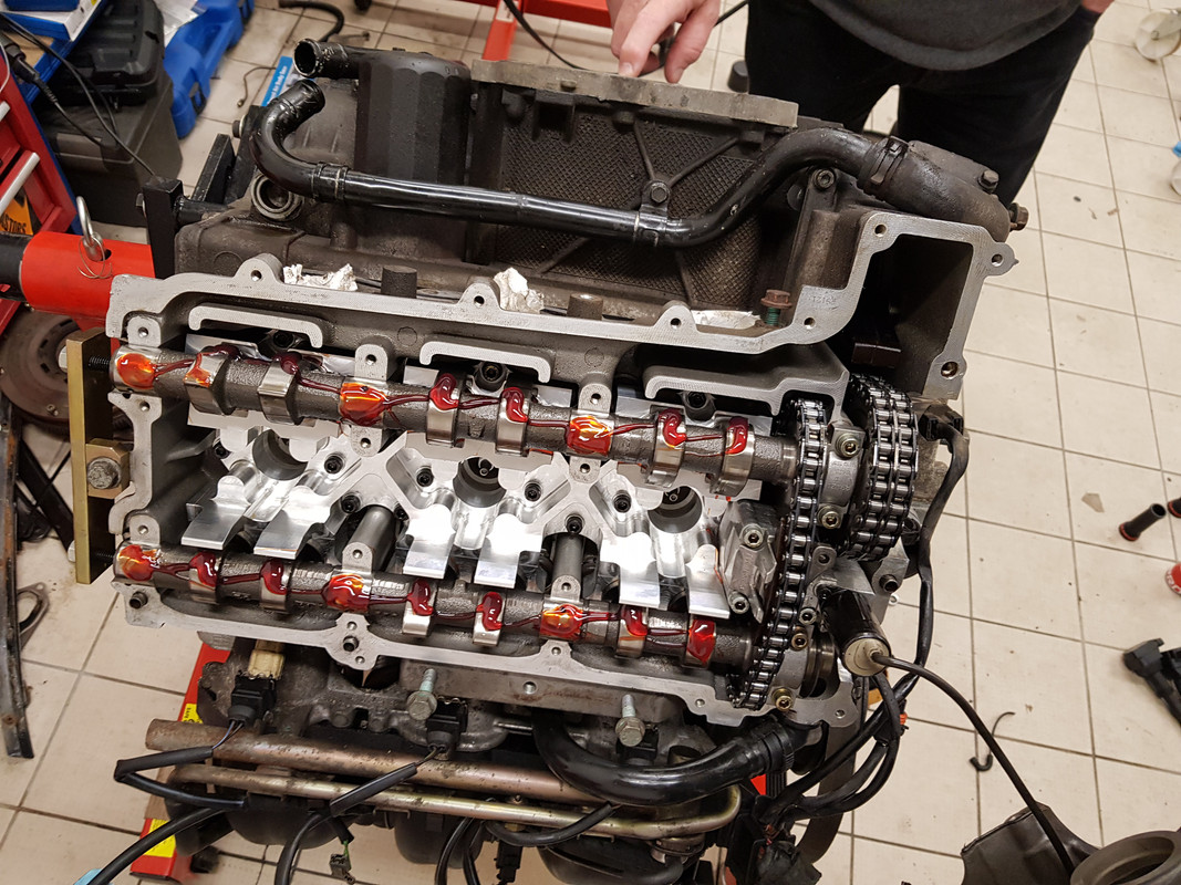

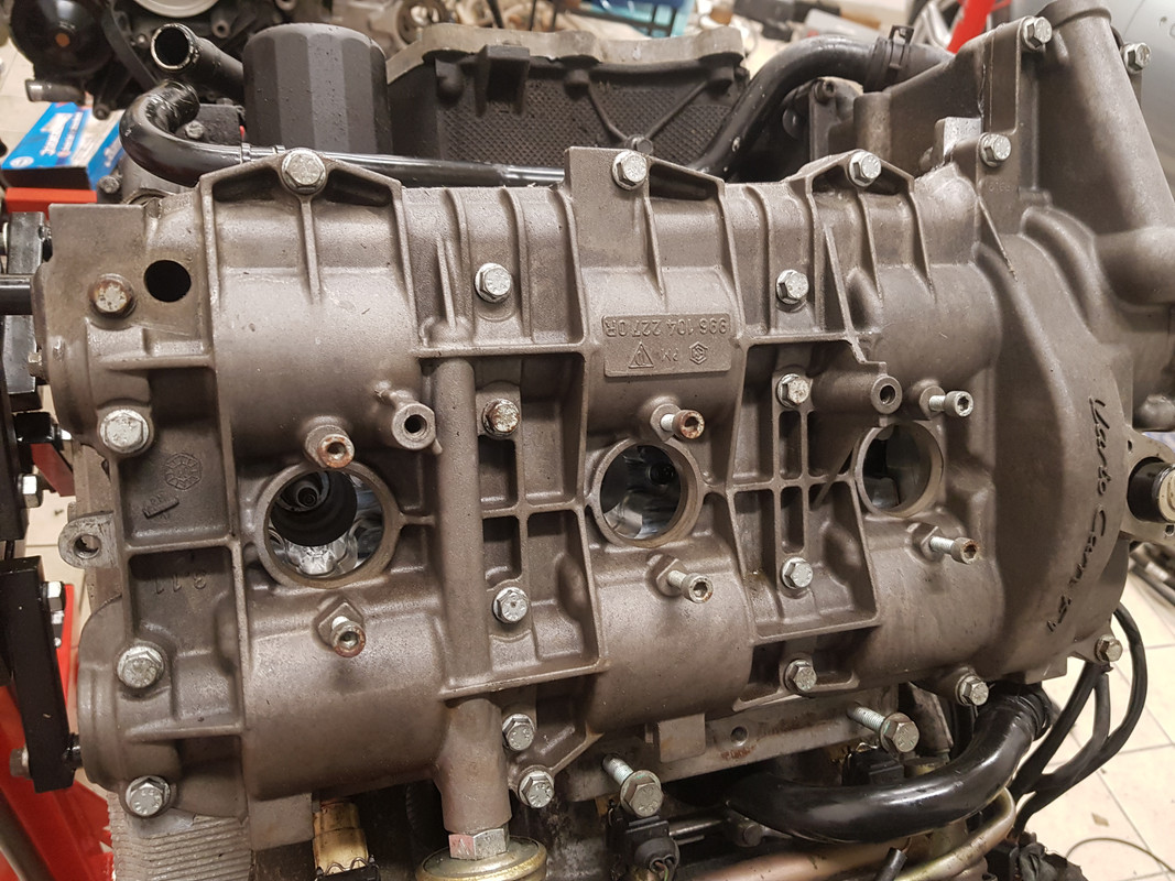

12/18/19 12:02 p.m.
Bolting things up ahead of running in.
It'll go in the car after Christmas. Somewhat nervous, bolting our own parts into an engine, but nothing beats empirical testing.
Also got a test segment of the sandwhich plate printed, and it plus the ITB clears in the areas that we were most concerned about - we'll get full three cylinder plates printed now for a final test, then have the final item machined.
