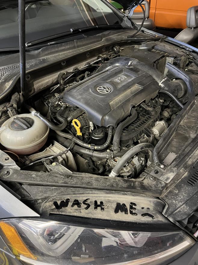

Brake master cylinders aren't exactly the most photogenic upgrades, so here's my disgusting engine bay. New position at work has me traveling to various sites under construction. I need to get serious about detailing
