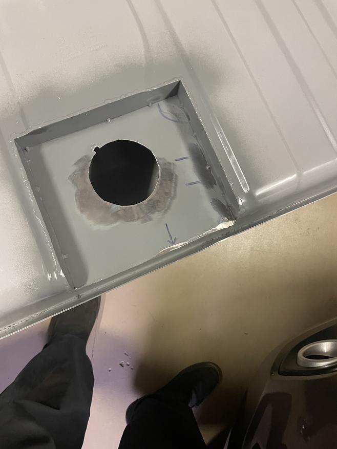

A while back, i modified my fuel tank to give me provisions for mounting a modern EFI sending unit, but I never leak checked my welding. So i rigged up my bike pump and pressurized the tank, and sprayed soapy water on the joints to test for bubbles.
Found and marked a few spots that needed my attention, but apparently I did a better job than I thought. I got those spots prepped/rewelded.
The next problem to solve is the sending unit. I have a China special sending unit for an LS1 camaro that I was hoping to modify, but it's just too tall. After recessing the top flange on the tank for clearance to the trunk floor, there's only 5.75" local depth inside the tank. The pump itself is almost 5" tall so that's no good.
I think i'm going to just fab my own "bucket" thing out of some thin sheetmetal I have laying around and call that good enough. I don't plan to really drive this car in anger so it'll be fine.

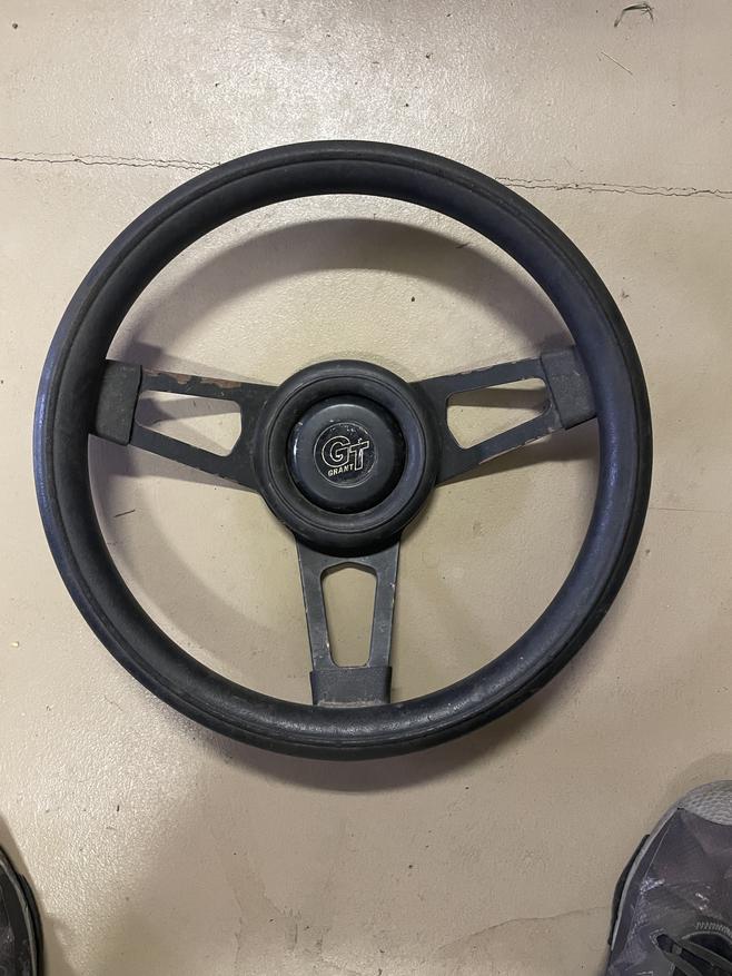

The steering wheel that came with the car was missing the horn button, so I snagged this sweet looking wheel on FB for $25 and i'm really stoked with it
