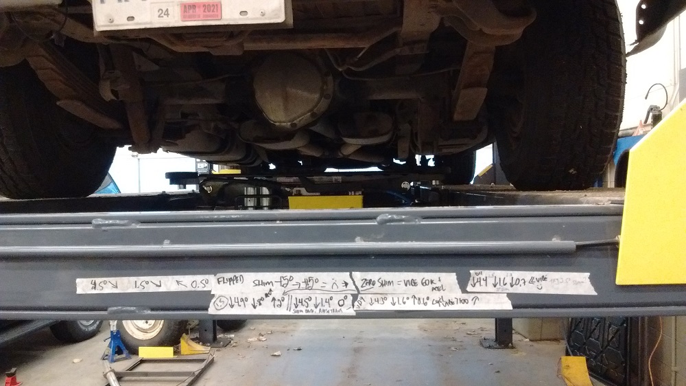

In other news, I've been spending the last month or so playing with pinion angles to try and get rid of driveline vibration.
One of the things I did was to raise the transmission as high as I could go (it's now 1/8" away from the floor). Marginal improvement.

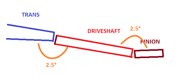

I guarantee you, matching the pinion with the transmission was NOT a good move.  Horrible vibration, probably because it makes the driveshaft angle up to the pinion, making for an awful operating angle for that u-joint, made worse under acceleration.
So I started moving the pinion the other way.
And, following the factory GM driveline NVH procedure, I ended up trying to focus on making the u-joint operating angles the same as priority #1.
Having machined a 3.5° shop to drop the pinion down, I ended up with this, and have the lowest amount of vibration ever.
I kept notes as I mucked with it:

I had machined another pinion shim, this time at 4° which has the trans tail down at 4.4°, and the pinion nose down at 1.2°.  Even less vibrations than with the previously aforementioned 3.5° shim.  I may try a 5° shim next just to see.
This is totally NOT matching and parallel.  Just so you know. Interwebs be darned all to heck. Matching and parallel was A.W.F.U.L.
