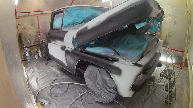

Sprayed a bit of epoxy primer to cover some exposed metal, and provide a bit more "hide."  Final sand next, then sealer and shoot.

8/11/22 2:20 p.m.
Was away in Tofino BC for a holiday.  Came back early because we picked up Covid.  This is my second go of it in three months, we'll see how hard it is on my lungs this time.
Making some changes to the spray booth filtration, then do some sanding, and hopefully spray sealer and colour tomorrow.

What did you modify in the booth?
I was never happy with the amount of spray that hung around in my home made booths. Air quality and dirt filtration was OK, but I am tempted to leave the far end open next time so that the air flows out unimpeded. More like a low flow filtered booth rather than a negative pressure  clean room.

I'm not pleased with the air flow, to be honest.
I have a honking big barn fan rated at 3200 cfm.  It can physically suck the 18x9' roll-up door move inward, and if you're not hanging on to the man door, it'll come at you when you open it.  I have the roll up door about 8" open, otherwise the fan just can't get enough air.
I watched a youtube video by "Trev's Blog," wherein he uses landscaping fabric for his filter, and shows it in action working smashingly. But I think they must have different fabric in the UK. I replaced the entire back wall with landscape fabric, and while I can breathe through it, the fan, clearly, cannot breathe through it enough.  I could do an entire wall of furnace filters (they work well), but this whole thing is already getting expensive.
I think I'm with you - leave the far wall open, and use the booth mainly to keep overspray off everything, and trust that I'm not going to get a whole lot of dust and bugs drawn in.
