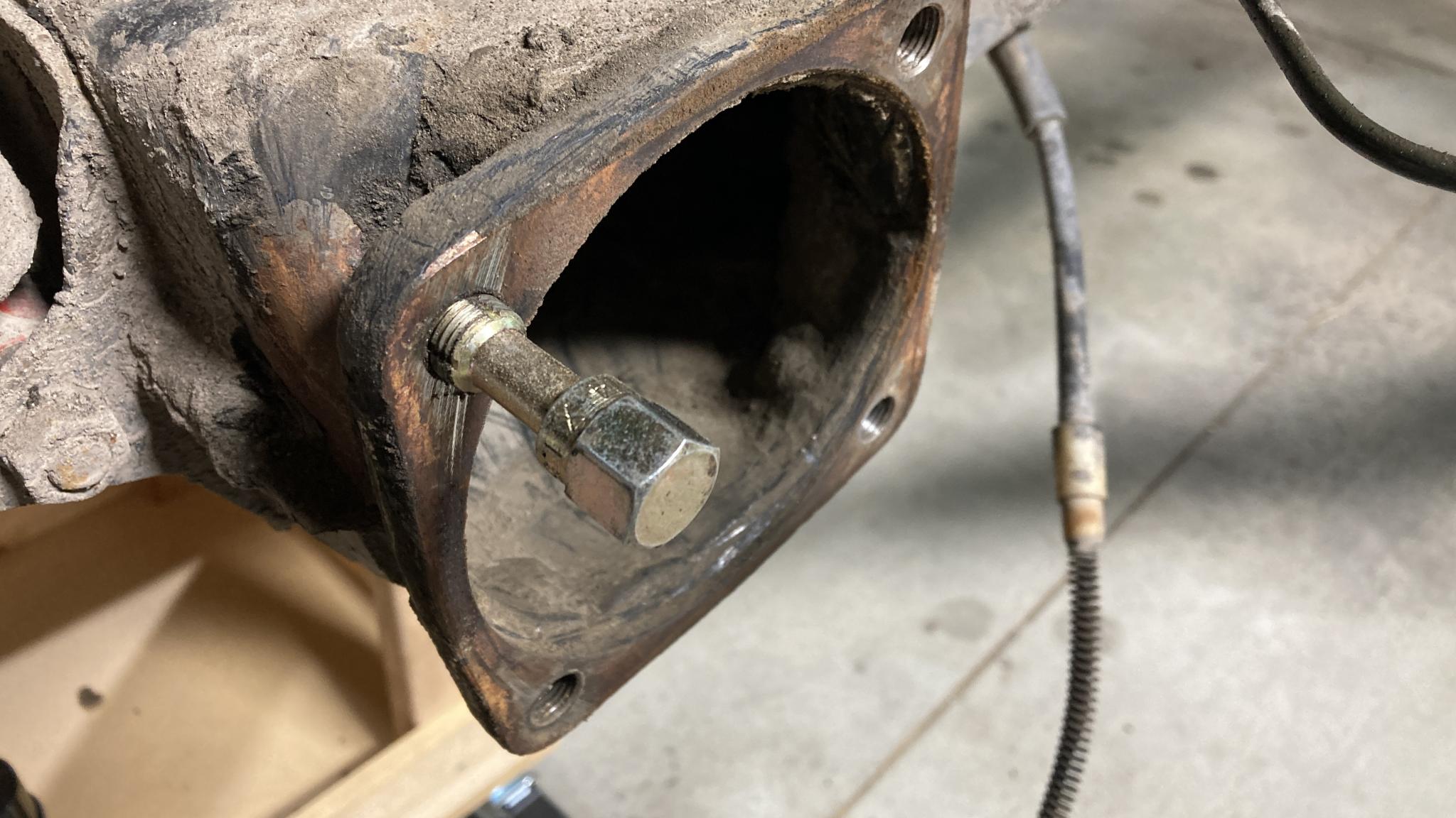

Some work has been accomplished. Once I finally managed to get the correct tool from my friend (we're trying to figure out why he even has a 10mm triple square instead of the 8mm needed for VW axles), I started working on the halfshafts. Clean up, tap the tool in and the first 6 came out easily. Possibly because they were lubricated. This transmission was going to need some attention before long.
The bolts for the outer CV are inside here.
They were much grosser. I decided to pull the hub assembly off so I could get a look. Much more gunk removal required!
Luckily, it's not too crusty, just goobered. I was able to remove it with a flathead screwdriver and a pick. And voila, the old halfshaft is off the driver's side. It's not pretty but it's only cosmetically haggard. Now it's time to repeat on the other side. I'll keep these off the van until the new trans is in place as it'll make it easier to work.
I also summoned my superior woodworking skills and made a cart for the engine/transmission to sit on. The last time I pulled the engine, I lowered it on to a pile of wood on a furniture dolly. This should be a lot more convenient and stable. It'll make it a lot easier to position everything with the drivetrain 30" off the ground.

Halfshafts are both out now. Not an single bolt put up a significant fight, thank goodness.
 While I've got various bits apart, I'm chasing all the threads with a rethreading kit. Just good practice with old cars.
