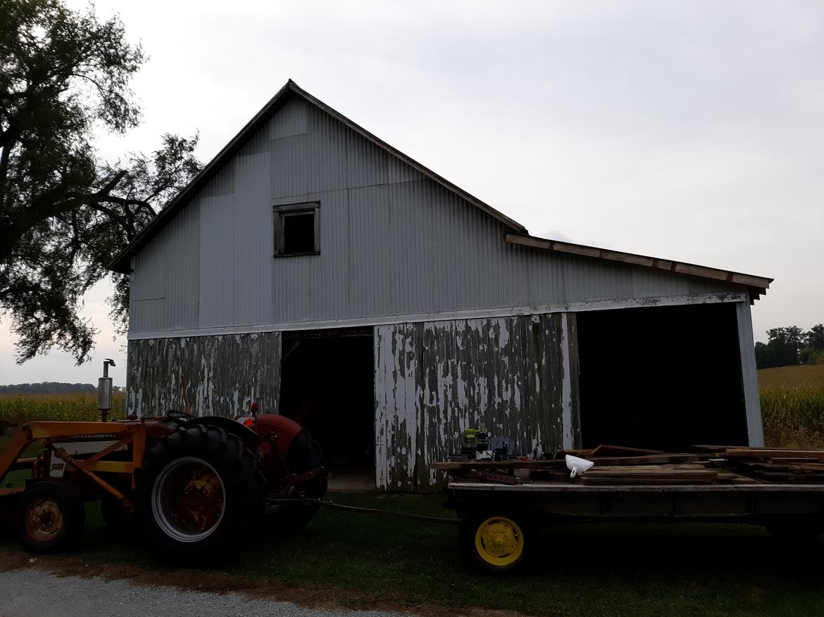

I've been getting a decent amount of work done on on the barn. I finished replacing the roof
I cut my rafter tails on the new rafters and added blocks to the old rafters because they were a little soft on the ends. Then I took some of my wider inch boards that had some bad spots and ripped them down to 1x5 for fascia boards. I also got the rest of the metal siding on the front wall.
The tractor and flatbed bale wagon have been awesome for this project. The wagon holds all the materials, serves as a giant work bench, and can driven right up to where you are working. I have my miter saw set up on there, and I clamp long boards to the edge of the bed so I can rip them with a circular saw. My scraps and cut offs go in the loader bucket and when it gets full I drive it over to the fire ring and dump them. It was also invaluable for hauling all the heavy oak timbers and long 2x's.
