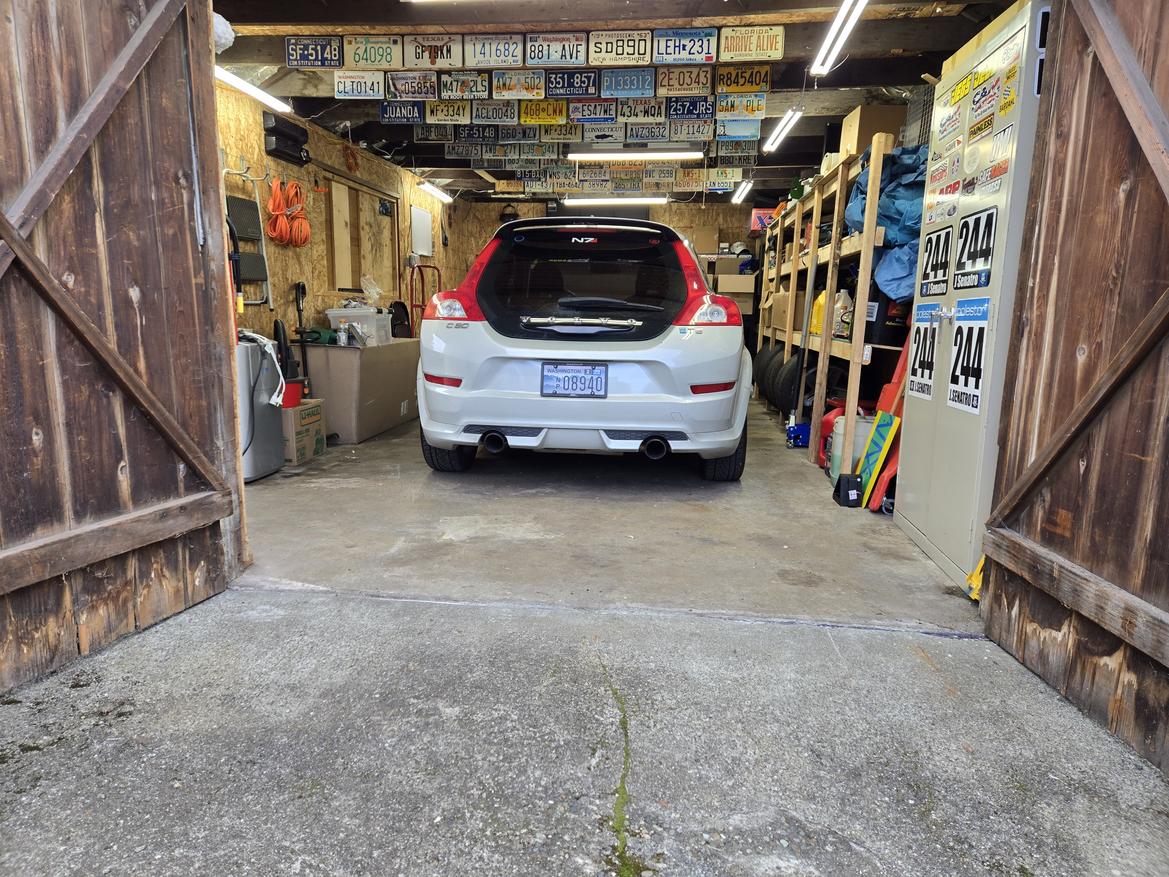

Saturday afternoon was spent cleaning and organizing the garage. getting my plates out of boxes and hung up and clearing enough space that I could actually get a car in there.
Speaking of plates, when It came time to renew the registration I wanted nothing more than to get those default rainer plates off the car. She now sports the National Park plates that were originally on the Camaro. A nice anniversary present for the young lady.
