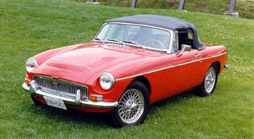

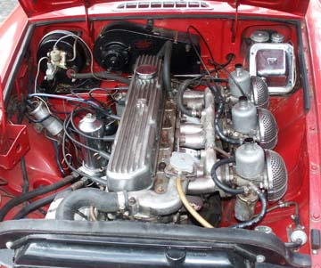

MG made two 'engine swaps themselves. One was the Rover 3.5 alloy V8 derived from the BOP 215.  The other was a straight 6 developed from the Austin Healey 3000 engine. In that one they needed heroic measures to get the engine in, including totally different front suspension using torsion bars instead of the coil spring MGB suspension.  This is an MGC I owned for several decades, with a modified triple carb engine that put out about 30 more bhp than stock.
