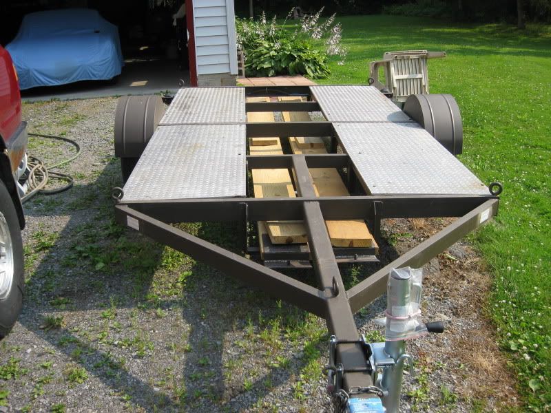

914Driver SuperDork
8/5/10 3:10 p.m.
6 X 10 deck, 19" off the ground. 3500 lb. axles, no brakes. Ramps underneath. Aluminum deck. I don't know what it weighs.
Big enough for a Neon. $900.

Did you build this?
I've considered a single axle trailer but the idea of a blowout scares me.
914Driver wrote: 6 X 10 deck, 19" off the ground. 3500 lb. axles, no brakes. Ramps underneath. Aluminum deck. I don't know what it weighs. Big enough for a Neon. $900.
