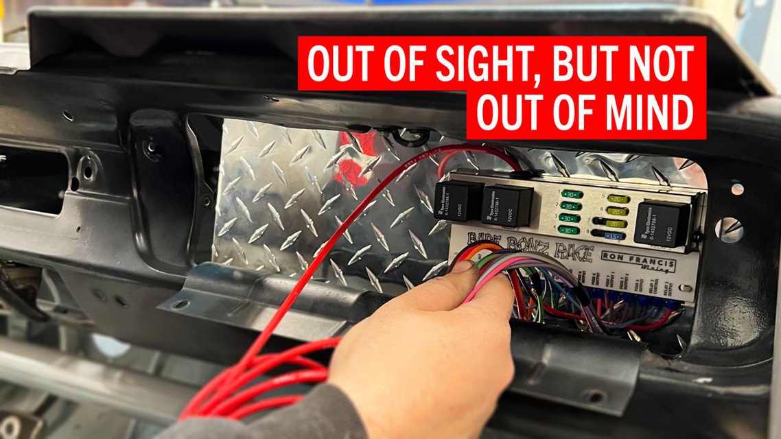

Before we could install the Ron Francis Bare Bonz wiring harness into our 1965 Mustang race car, we would need to mount the fuse panel.
A few considerations on where to put that panel:
  • Whenever possible, try to keep weight low and inboard of the wheels while also offsetting the driver’s mass.
  • Electronics favor a cool, dry location.
  • Centered …

You had me scared there for a moment, I thought you were 3D printing diamond plate now.
