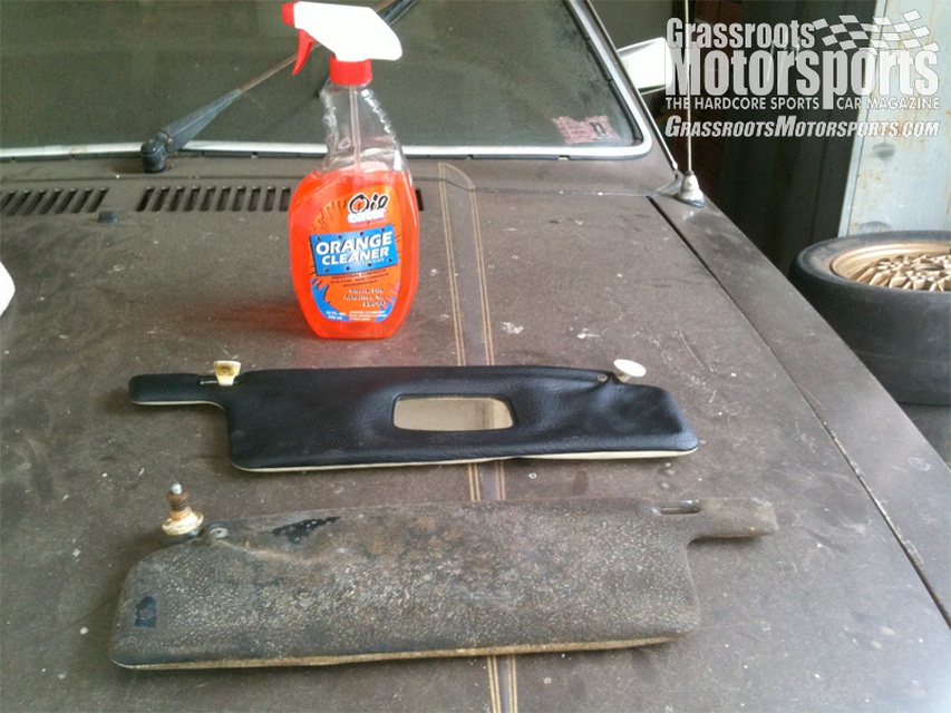

With the floor solidly in place, we decided to clean some of the interior parts. The Scirocco has been dormant since 1986; all kinds of greasy funk had found its way onto the car’s upholstery over the years. We had grown tired of soiling our hands and clothing each time we brushed up against a sun visor or door panel. We grabbed a bottle of Oil Eater’s Orange Cleaner spray and it worked remarkably well. The visors were transformed, the door panels came clean easily, and the nice orange scent reminded us of driving down to the Sebring 12 Hour Race. As a bonus, Orange Cleaner is 100% biodegradable and Earth-friendly.
