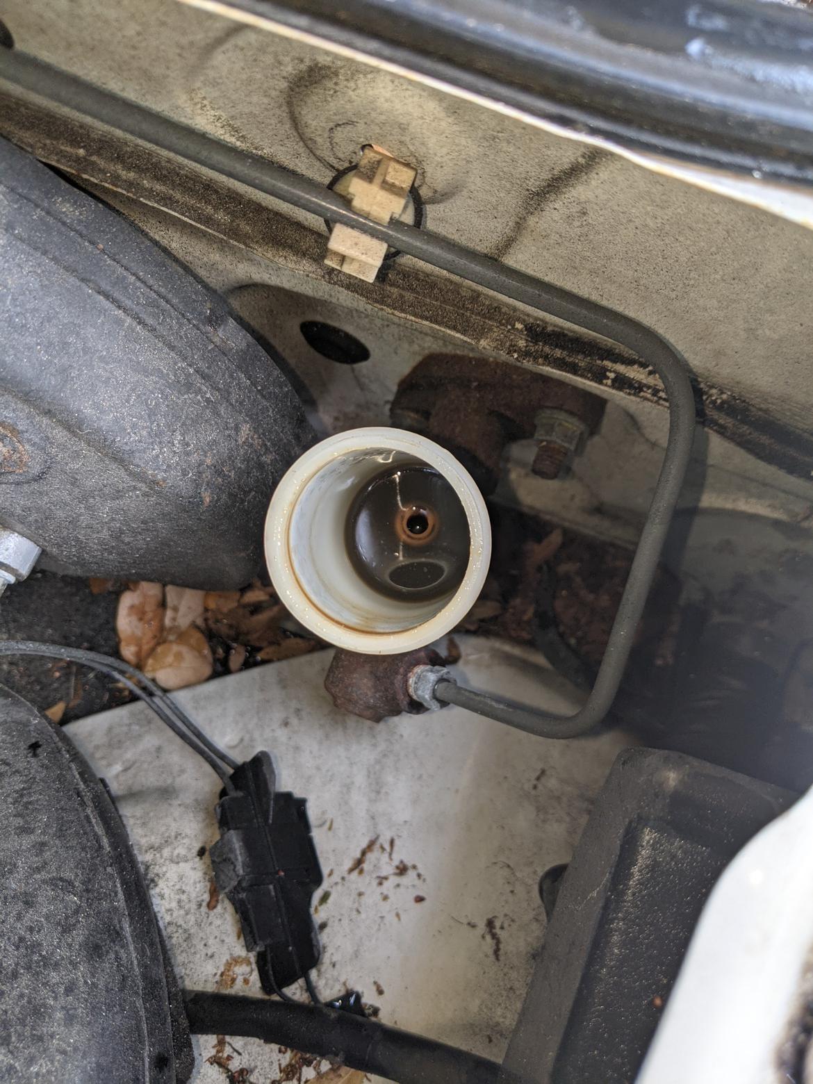

Fluid is the clearest I've ever seen..........

Ok so in typical House of Stampies fashion we haven't done anything other than fill up the clutch master. That level has stayed full but after sitting a few days you can tell the issue is still there. Why fix it when you can spend 30 seconds pumping the clutch before putting it into first gear? Today we went to the store in the Miata and it was bad enough that I actually debated if I could drive all the way back home with a fully engaged clutch. So let's fix this thing. Obviously the slave is the highest chance of being the issue. But do I just go ahead and replace both? Then looking at Flying Miata they have a stainless braided line. I mean just that is worth like 5 hp right?
