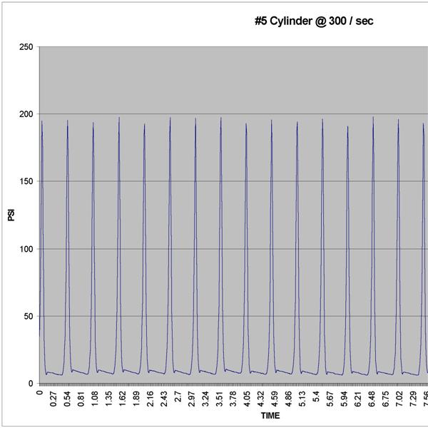

If you want to take a drive up to my place here in MA I can do a comprehensive compression test on your car. I have developed test equipment specifically for the rotary (I have had many of them and got sick of having a dealer charge me for the test)
Here is an example of what I get from my testing.

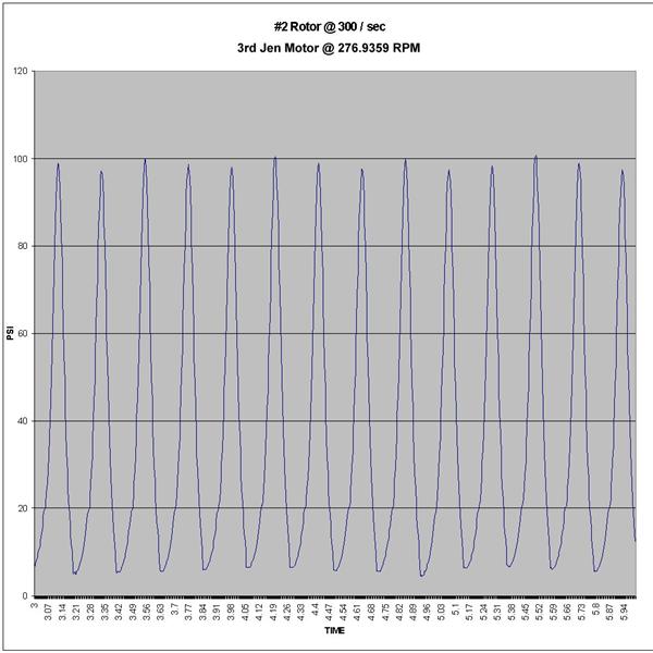

And for those with piston motors I can test those as well. This is what I get.

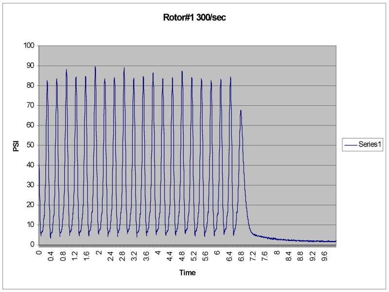

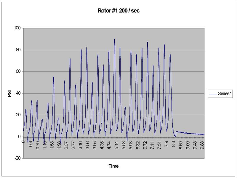

Yep. I can tell allot with this tool. I have some fascinating graphs of cars with "issues" It really can give you a really good idea as to the health of your motor. A lot more so than a regular compression test. A subject for another thread for sure. I was trying to market it and sell it but ran out of time and since I was purchasing a house at the same time ran out of $$$ to back it as well. That was 4-5 years back I should probably re visit it now. But I then started the 944 steering shaft rebuilding side business and that has been providing some real good beer money. So this has been on the shelf.
The biggest hurtle was finding a programmer that can write software that can handle the graphing part of it. I tried to teach my self to program but I quickly realized I am better at working / building hardware things. Software programing is an art all in its own. I have come to admire those that can program and do it well. It takes a completely different way of thinking.

For instance here is a car (my old rx7) with carboned up apex seals
Here it is again after a good ATF treatment.
Got it back to acceptable Compression.
