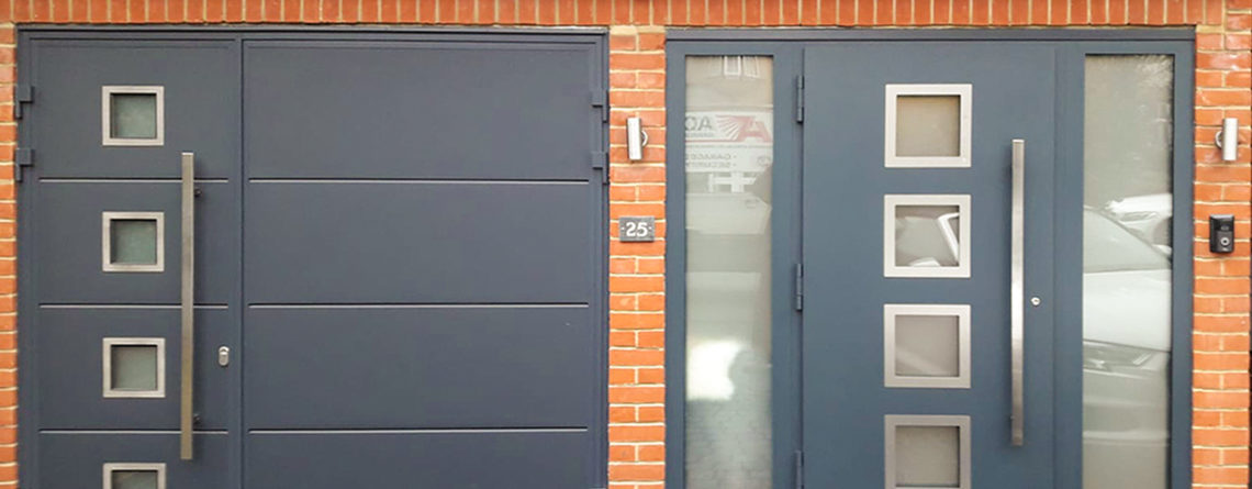

A bit of context, my wife is ok converting the space, but she still wants quick/easy access in/out and a traditional garage door doesn't fit the bill for her.
Regardless, I got a surprisingly fast response for a quote and price is ~$5k with a 22 week lead time, sooo... not really an option.
The new race car is ~75 inches wide with non folding mirrors. I had considered getting a set of 78 or 80 inch french doors, but those don't seem to be a standard offering. Plus I'm sure the threshold isn't really designed to take the weight of a car rolling over it.
Barn style sliding doors don't fit the bill either.
Most likely a hinged carriage door is the best option, though an offset split seems like a custom or semi-custom configuration. So, maybe not much better on price or lead time than the crazy door in a door (insert Xzibit meme here) laugh
Something sort of like this:
Ryterna Wide Horizontal Ribbed 30:70 Split Side Hinged Garage Doors  Finished in Anthracite Grey
