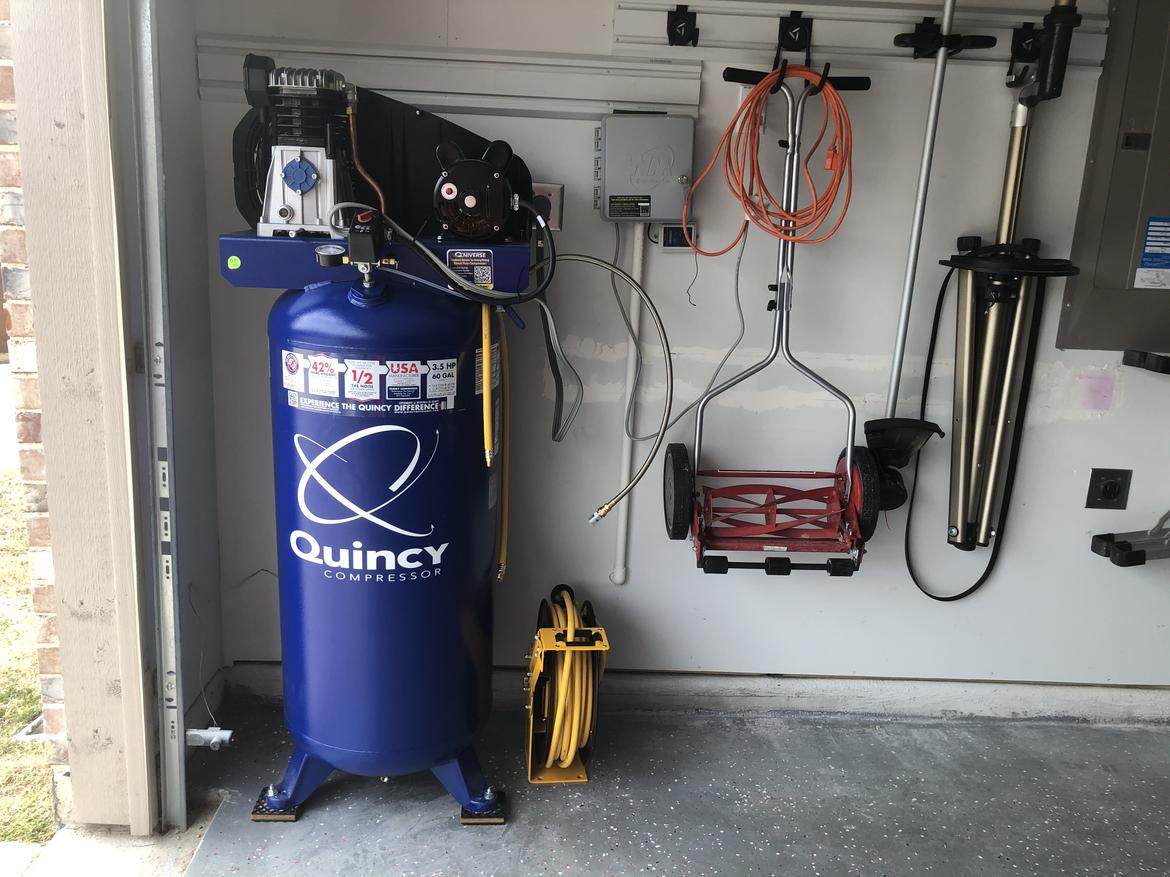

Got wiring done today.
Got floor anchors installed too.  Now I just need to decide how to hang hose reel and regulator.
You can also see the plug for the welder below the panel.
The lift power will route to the same location as the compressor via conduit and also get a cord end.
If anyone needs 10 ga wire I have extra and its expensive.
