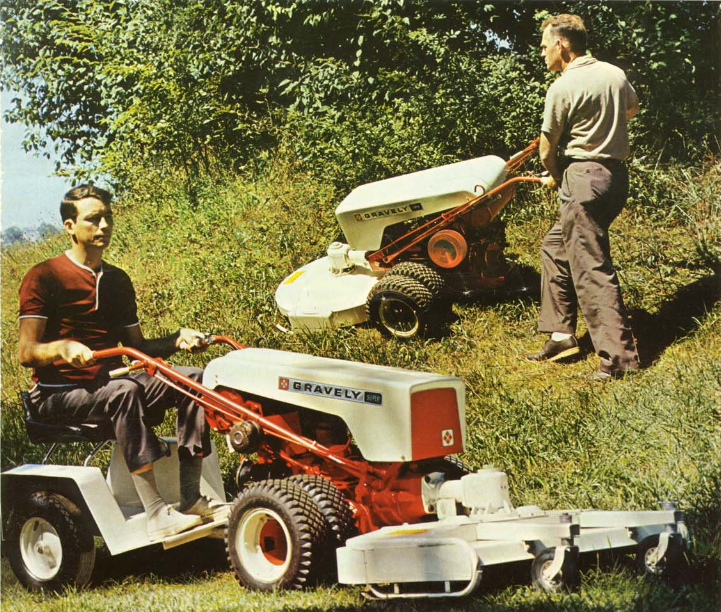

stuart in mn
stuart in mn MegaDork
11/27/21 8:58 a.m.
John Welsh said:
Two wheel tractors are very popular in 3rd world countries.
Gravely used to make a two wheel tractor, you can still find them from time to time.  For that matter, most any old four wheel lawn tractor could probably be made to work.
jh36
jh36 GRM+ Memberand Dork
11/27/21 9:03 a.m.
In reply to BionicTigerShark (Forum Supporter) :
The Walmart cart pusher would be pretty uptown. There's one for sale near me actually but it's pricey. I'm not so sure if it would work on gravel though.
The gravely is killer. Ed, strap this to the Mercedes on your way back from PA?

jh36
11/27/21 9:42 a.m.
I'm really leaning toward the gravely idea. And if I find a complete one, I could actually mow with it. My 72" in JD tractor only gets me so far and my old push mower was crappy when new.
The other option would be to scratch build an electric device but I think I'd rather work on the project cars.

Ian F (Forum Supporter)
11/27/21 9:58 a.m.
One issue with something to push a car is the traction-to-weight.  Trailer dollies use the tongue weight of the trailer to help keep the dolly from breaking traction under load.  Something capable of pushing a car will need to be fairly heavy simply to keep enough vertical pressure on the tires to keep them from spinning under load.  So whatever you build will need to be pretty damn heavy. A pair of bus batteries might do the trick.
jh36
11/27/21 10:00 a.m.
In reply to Ian F (Forum Supporter) :
Another reason a gravely might be cool. I've never used one but I think the seat can essentially be a counterweight.
