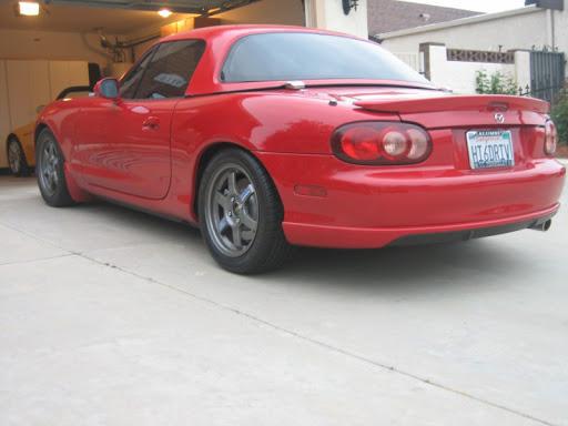

NA and NB hardtop are interchangeable. There were lots of discussions and people told them they won't fit in the early 2000s .  I prefer them without defrosters, but to each their own.
Here is my 1991 OEM Hardtop that I took from my NA and it fit perfectly on my NB MSM.
I have 3 hardtops, and have paid $300-$800 for them. Locally $1,100 these days seem to be the going rate. Unless you run into a "I know what I got" type of person.

No question they are interchangeable, but the options such as headliner, etc varied.
However - the latches changed in 2003. If you mix and match across that line, they're not really going to latch properly. It'll look like it works, but it's not as solid as it should be. Change the striker plates or the latches to match each other.
Hardtops have always been around $1k. I got my first hardtop in something like 1994 and that's what they cost then. What's changed is the number of haggard ones out there. The average quality is dropping, so the really good ones are going up in price. They're also a finite supply, so they are gradually getting harder to find used. There are new ones available but they cost what new ones have always cost.
I've seen a couple of track versions and they've not been all that impressive for street use. If you're looking for aero and don't mind a lack of seals around the sides and a riveted in rear window, go for it. But it's going to be a different beast than a factory unit.
And yes, just like cars, every once in a while you get an outlier.
