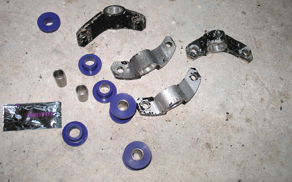

Installing new suspension bushings is a very labor-intensive job, but one that will pay off with a more precise suspension and improved handling. Stock rubber bushings are biased toward ride comfort and vibration reduction. Replacing these components with ones made out of stiffer material, like polyurethane or Delrin, will result in better performance. Here’s a quick look at the steps …
