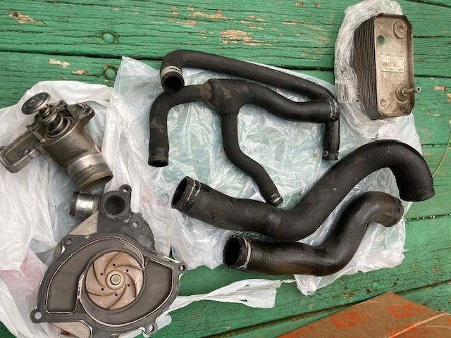

Recent highlights:
Both rad fans replaced with 50k used units late July 2024 after one of the resistors had failed at 154.4k. Saved over $850 what they would have cost new and I now consider the cooling system to be throughly refreshed.
