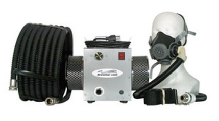

I recently bought a supplied air system from HERE, which seems like a smart move, especially if I spray again. Or cut concrete. Or that chili-cheese-burrito-enchillada platter. For only $400US ($900CDN, landed), it's hard to say "no" to that when it comes to health.
