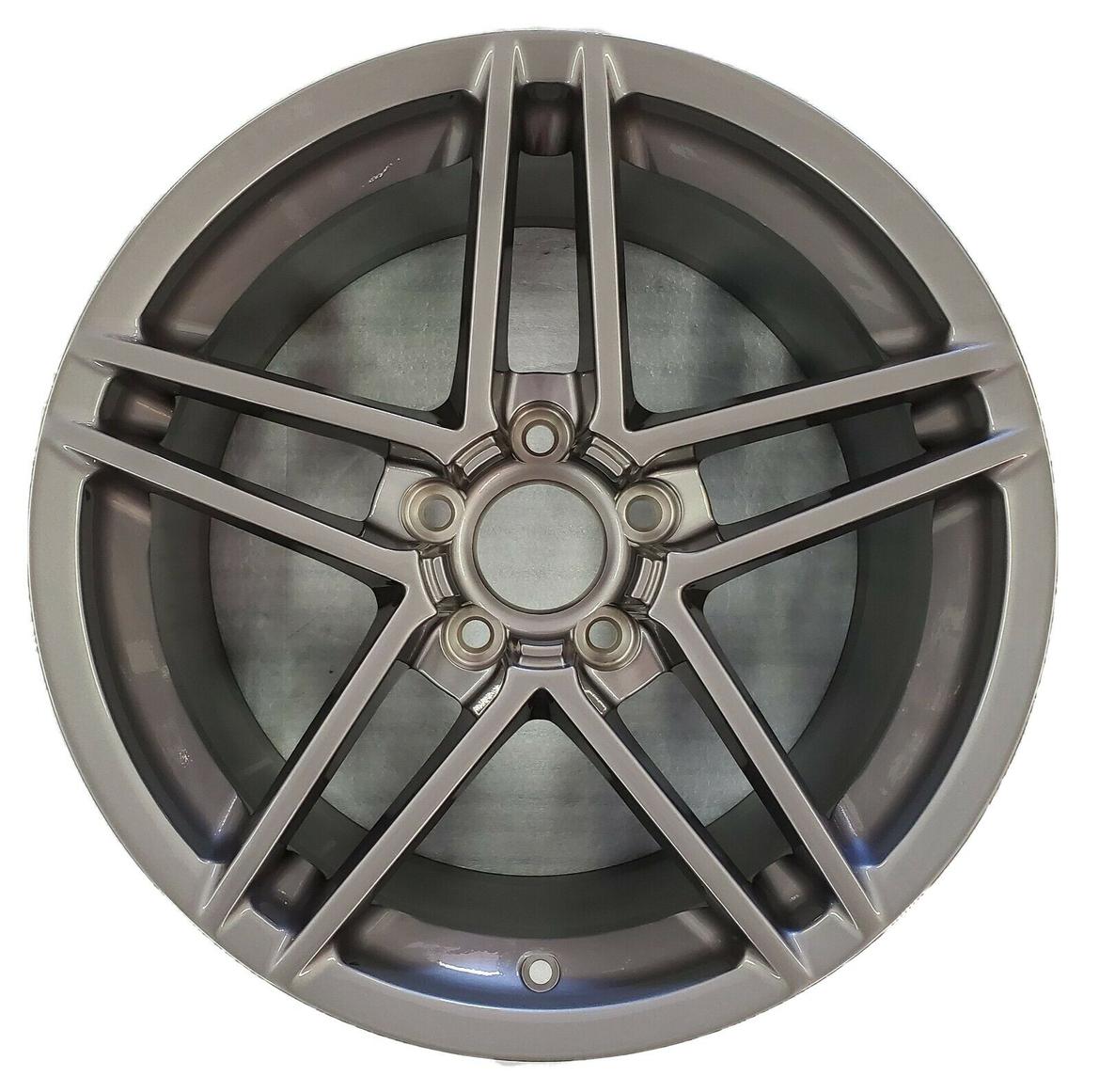

It's the age old question.  I'm weighing tire options for my newly acquired 4th gen F body.  The tires on it are old mismatched and terrible.  The car stock is an SS so it has 17x9 or 9.5 inch wheels and wears 275/40/17s.  I may buy some Corvette front wheels (set of 4) and upgrade to 18x9.5s with the same offset.
I really want a set of tires that does it all.  Figure the car will do 2-3 autocrosses a year and maybe one TNIA a year or something along those lines.  It might even see a dragstrip once a year, and it'll be driven on nice days to enjoy the V8 rumble.
Rallycrossing.... I'm going for a full season there so that limits times to take this car out and use it in anger.  Mileage will only be 3000 or so miles a year total.
Do I get tires for the 17s and not worry about going 18?  Do I get the tires taken off the 17s and store the wheels and buy 18s?  Which tire do you go with?  Falken FK510, Firestone Firehawks, Conti ECS, Michelin 4S (big money here), or go with something more hardcore like the Hankook RS-4 (can get in 255/40/18) or the Falken 615?  I'm not looking to be the TNIA hero, drag race hero, or next CAM champion, but I don't want tires that suck at everything either.
I have Conti ECS on the Boxster and they are quite nice.  The Subaru got Potenza S007s and they seem okay for that (they were way cheaper than RE71s on closeout, and I'm not that good of a driver).  What should I do on the F car?
I can get new Corvette Z06 fronts in 18x9.5 (C7) in grey for a decent price.  It's expensive, but they would look incredible.  Will an 18" tire offer that much more selection and performance?  It would probably update the look of the car a lot.  It'll also give me new wheels and we all know wheels are consumables too.  The originals have 183k miles on them.

At $183 per tire they seem reasonable too in 17.  In 275/35/18 they are just over $200 a corner. I found a pretty solid deal on 4 new C6 Z06 front wheels in 18x9.5 too.  I could put DD tires on them or DD tires on the 17s.  I know 315s are the ultimate size all around, but finding wheels with the correct offsets doesn't seem to easy (most are running Corvette rears with pretty substatial spacers from what I can tell).  That may require custom wheels or fender rolling to get perfect.

Well I just accepted a new job, so as a treat to myself I bought the Z06 wheels.  I'm going square 18x9.5 with the correct +50 offset.  This keeps me from needing spacers and keeps tire diameter and width the same.  Now I need tires for these wheels and perhaps a set for the 17s too.

The wheels arrived.  Instead of waiting 2-3 months to get RT615s, I ordered a set of Falken FK510s which should be here tomorrow.  Discount tire price matched Wal Mart which had them on special.  I saved $40 per tire.  Given TX is turning into a swamp again, I may need more tread.
