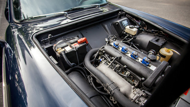

What about the Mazda/Ford MZR based engines out of a Ranger? I believe those are aluminum block & head setups which would save weight. Should be a lot of transmissions out there to use if you don't want the Ranger unit. Another idea would be a 1.8 BP with a supercharger as it would hit your power target and the parts aren't rare. I know this isn't an NA setup as you outlined but they sound awesome.

Problem with the MZR is it's front-sump as well. They're good engines, but if I'm dealing with a sump conversion/crossmember hack job, I'd rather do it for a K24 or 3SGE.

Question- do you need 200whp now or the potential of doing that in the future?
Question 2- do you have a picture of the cross member relative to the engine? Sounds like an Alfa motor swap would be out due to the front sump issue, too. Which I think is backward from the Miata (but I've not really paid attention to).
Anyway- it seems like the BP motor would fit most of the bills. BTW, if there's any interest in the modern Duratec/MZR- remember that engine is what is in NC's. So if the sump is ok on it, then you can source that motor. Or at least parts for a Ranger.

I may just need the potential for 200whp in the future. I'd be okay with Miata-levels of power now, but the K24 really appeals.
If I could get my hands on a welder for the house, I could swap in a Miata engine and probably still stay under the Challenge budget. There's always that.

Found this wonderful list of dimensions. Looks like a BEAMS will fit neatly between the front steering link and the firewall pretty easily. That'd require a custom subframe, but I think that's going to be required for pretty much anything but the Miata engine.

General Motors Atlas 2800/2900. Looks to be rear-sump from what I can see, available at U-Pull yards cheaply, and 200 WHP would be a different airbox and silencer away.

chaparral wrote: General Motors Atlas 2800/2900. Looks to be rear-sump from what I can see, available at U-Pull yards cheaply, and 200 WHP would be a different airbox and silencer away.
Interesting idea. Aside from being cheap, I'm not sure what advantages it would have over a Miata engine for this chassis, though. I can't image at 2.9L it's very small.

Rotaries, 4 cylinders, and even a few v6 engines will fit. But that trans tunnel is so small I think the transmission should be the deciding factor.

Ojala wrote: Rotaries, 4 cylinders, and even a few v6 engines will fit. But that trans tunnel is so small I think the transmission should be the deciding factor. If it was my decision that is.
Yeah, I think the trans tunnel is going to be hard. It's just so damn short, with the shifter in a weird position (relative to a modern trans). Not that many people have transmission dimensions laying around. On paper, I think I want to go with a 3SGE. But it's going to take a little butchering of the trans tunnel. The only swap I've found that people do without tunnel work is a 90's Volvo engine (B21/23/230). It more or less bolts up, and I suppose I could get excited about a B230T, but they don't seem to be super easy to find.
