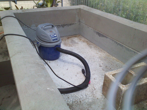

The salt water pond, not yet sealed

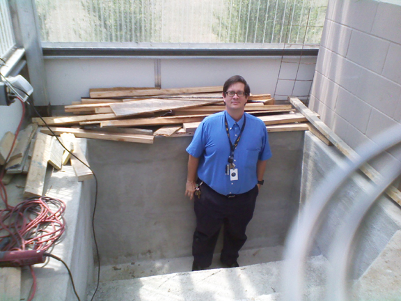

upper level of two-tier freshwater tank. The wall at the left will be notched to allow a waterfall into the lower level
photo showing both levels

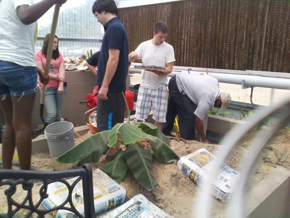

students digging out one of the raised beds to make room for another freshwater pond

The one the students were working on is actually going to be around the base of an artificial tree that will be covered in arboreal plants that like it VERY moist. The "trunk" will contain a pump that pulls water out of the pond and forces it to the top, where it can trickle back down to the pond. In the process, it will keep the plants growing on the "tree" nice and wet.

I want to put a pond type aquarium in my yard so bad, and I was thinking about doing the two tier one the guy in the blue shirt is standing in up on the top photo.
JoeyM
JoeyM SuperDork
4/14/12 9:20 p.m.
That's me....the tank actually has one additional level halfway between the visible one and the bottom where I am standing....it is no wider than a stair step. The reason we are looking for an inexpensive sealant is that the recommended ond costs as much as the concrete.
